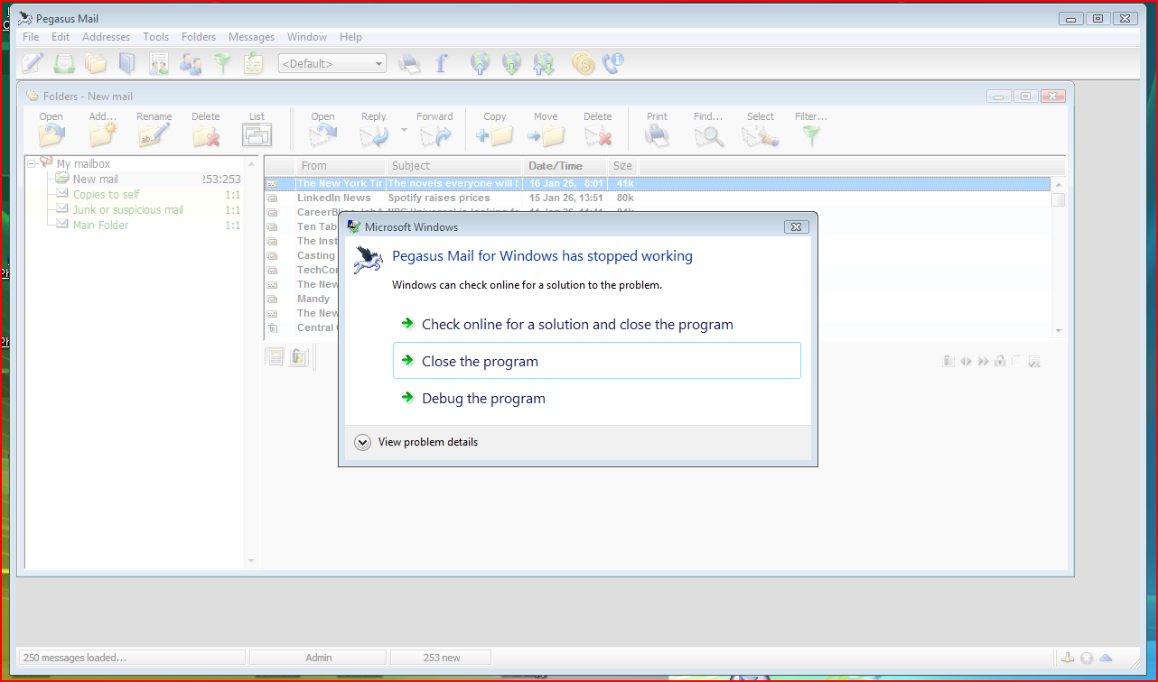

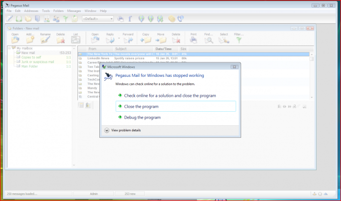

I have had this issue for years, on many versions of Pegasus, and haven't found a solution.
When I go to create a new folder or tray, as soon as I click on the "Add" button, Pegasus freezes and I have to use Task Manager to kill the process. Its OK when I then go back into the program.
It makes no difference if I try to create a folder direct off "My Mailbox" or off an existing sub-folder.
I had this problem for years, yesterday I upgraded from 4.72 to 4.91 hoping that this may be fixed, but it's still there.
I tried renaming "HIERARCH.PM" away, and starting Pegasus, which loses my trays, and recreates a new HIERARCH.PM file.
But the problem persists.
I let Pegasus create a new HIERARCH.PM file, exited Pegasus, went back in again, and as soon as I click "Add" then Pegasus freezes!
Is there some other Pegasus configuration file that could be corrupt and needs fixing or deleting?
Any hints or advice on this gratefully received.
