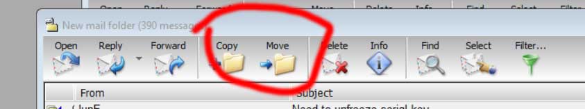

swmech posted Aug 17 '25 at 3:52 am
My mom is a Pegasus user, and somehow managed to move her mail reader window so that the title bar and the button bar are off of the parent window (above it). She's unable to use any of the buttons that she's used to, as they're not visible any longer. I'm my family's unpaid tech support, so I tried to figure out how to move that window using the keyboard. The usual "alt-space" opens the system menu of the application (parent) window rather than the reader (child) window. The window can be closed using the ESC key, but the next reader you open opens in the same off-window position.
Since that window opens in the same place even after you close the application I looked for INI files or registry entries that could be updated, but while I found several "xyz Rectangle" entries I didn't find any that contained negative coordinates.
Looking for a way to move that window back fully into the parent window. Suggestions welcome, and thanks in advance.

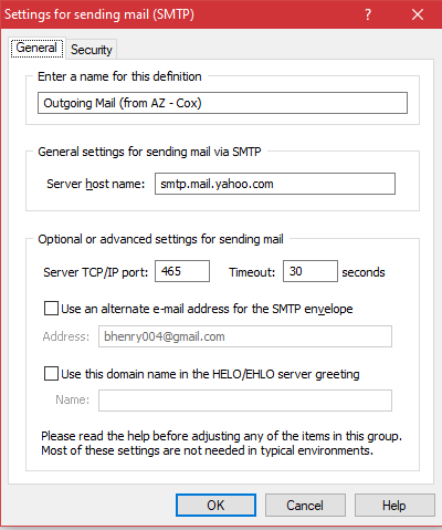

bhenry004 posted May 12 '25 at 11:59 am
I am using POP3 to collect mail on 3 different servers, TWC, Google and Yahoo (for 2 different mail addresses). Connection to the first server (Google (OAUTH2)) collects mail and starts the new mail filtering process. I can watch the progress window go through the "Getting mail headers" and "Applying mail filtering steps", then the second server (Yahoo) gets a timeout error:
Setting SNI hostname to 'pop.mail.yahoo.com'
OpenSSL reported error during handshake - 1/5 ...
* OpenSSL supplied no extended dialog information
After that timeout, server number 3 (TWC) retrieves mail and goes through the filtering process. Then Yahoo is opened again for the second email address but get the timeout error described above.
When I go back and use the "Check your POP3 host for mail" icon, mail is retrieved successfully for the first timed out server 2 but fails again on the next server. I have to go back and select mail a third time to retrieve all my mail.
This pattern is consistent and the timeout seems to follow the filtering process of new mail.
Any ideas?
