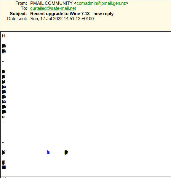

But I am still without working scroll bars for the folder list and the message list. The message pane scroll bars do work. Does anyone know what calls WinPM makes to the OS or to other dlls to get scroll bars to work? Knowing that might help in the inevitable negotiation with the WineHQ crew.
However the message pane is only useful in plain text mode and even then it sometimes looks very similar to the attached image. Any attempt to read the "pretty" version is "pretty awful" as in the attached image.62d42fff7935e

The attached image is weird. I see an H at top of body in box, but shows just one character.
