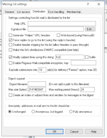

BUT I can confirm that Version 4.91 has a serious bug in the handling from mailing lists. How: I do have a second install of Mercury at a different location, it is 4.8, as it is still on XP as an internal setup.
I created a test list with the exact same settings and it is working fine. What I found is, that Mercury is sending From (internall handling) in 3 ways the list emails:
1: using the FIRST moderator email in the moderator list
2: if no moderator is set, using the error handling email
3: if neither of both is set, it is using the submitter's email
The receipient will see only the submitter email. So much for the handling of the internals of Mercury, which you propably know already. I just mentioned it for completeness. I had to get my head around this, as I was not used to it from my old system.
Now to the bug in 4.91
I have 2 moderator and 2 error email set. Both are the same for moderator and error handling. Mercury is sending FROM (internally) with BOTH emails as ONE email. That is clearly shown in MercuryE log above. Or additional here which shows it better
T 20230425 091912 64474e62 Begin processing job MO000049 from <>
T 20230425 091912 64474e63 Begin processing job MO000048 from <>
T 20230425 091912 64474e64 Begin processing job MO000047 from <>
T 20230425 091912 64474e65 Begin processing job MO000046 from <>
T 20230425 091912 64474e66 Begin processing job MO000045 from <>
T 20230425 091912 64474e67 Begin processing job MO000044 from <>
T 20230425 091912 64474e68 Begin processing job MO000043 from <>
T 20230425 091912 64474e69 Begin processing job MO000042 from <>
T 20230425 091912 64474e6a Begin processing job MO000041 from <>
T 20230425 091912 64474e6b Begin processing job MO000040 from <>
E 20230425 091912 64474e62 Permanent error 11001 (non-existent host or domain) resolving 'sasktel.net admin@yorktondigit'.
E 20230425 091912 64474e63 Permanent error 11001 (non-existent host or domain) resolving 'sasktel.net admin@yorktondigit'.
E 20230425 091912 64474e64 Permanent error 11001 (non-existent host or domain) resolving 'sasktel.net admin@yorktondigit'.
E 20230425 091912 64474e65 Permanent error 11001 (non-existent host or domain) resolving 'sasktel.net admin@yorktondigit'.
E 20230425 091912 64474e66 Permanent error 11001 (non-existent host or domain) resolving 'sasktel.net admin@yorktondigit'.
E 20230425 091912 64474e67 Permanent error 11001 (non-existent host or domain) resolving 'sasktel.net admin@yorktondigit'.
Without my 4.8 install on a different location to which I can point to (DNS) for the particular domain, I would not be able to use the mailing lists in Mercury. ![smile](https://community.pmail.com:443/sites/default/assets/img/smileys/sweat.gif)
