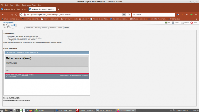

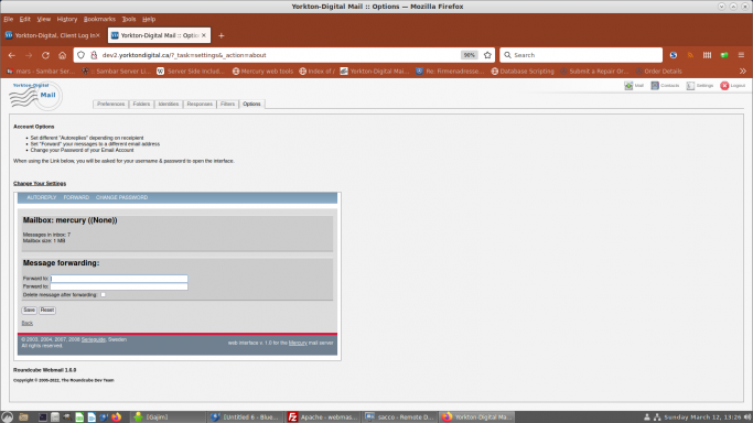

Hello Joerg,
the autoreply using Rolf's webtools is working perfectly at my installation. To give my users the ability to change the settings for autoreply, autoforward I have incorporated this into my roundcube installation. This way each user can access this for his/her mailbox.
In your case using Thunderbird or any other imap client, you would just have to create a small webpage to integrate the webtool's url and make it password secured at the front and after login use the link to the tool. After clicking the link of the tool, the user will be asked for his account name and account password.
This way, the user has only access to the user's option, not all admin options.
I have als changed a few files of the tool to show only the options I wanted.
Attached are 2 screen shots.
64dfe51b6f523
64dfe51c90d54
If you need more info, let me know. We have see how to get in contact as we don't have a PN system on this board.
Johannes
