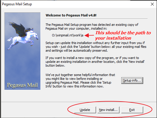

IMPORTANT NOTE: Another anomaly has recently been discovered that can occur during the upgrade. It is very rare too, but IMO, is a show-stopper without obtaining advise on how to proceed. The image below is what you should see when you run the 4.81 installer. Note the installation path and the buttons: Upgrade, New install, and Exit. If you don't see this window, exit the installation and post back.
