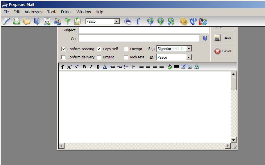

Demo of too high message window at "Start a new mail message".
The same at "Reply".
6786bf7d719ca
Demo of too high message window at "Start a new mail message". The same at "Reply". ![6786bf7d719ca](serve/attachment&path=6786bf7d719ca)

As Euler suggested, Window > Cascade (or Window > Tile) should resize the window within the Main Pegasus Mail window. You and then resize and reposition it as you like. Best to do this with all other windows closed.
In this case, he can simply use Window > Enlarge (Shift+F4), as long as he clicks anywhere in the editor window to give it focus. After that, he can resize the editor window to suit his needs and close it to save the settings.
I "played" with F4 which resulted in a huge enlargement of the windows, but in such a way that the desired "start" window came within the boundaries of the PM window. Then I reduced it to my liking and I got what I wanted.
Thank you, Euler!
I "played" with F4 which resulted in a huge enlargement of the windows, but in such a way that the desired "start" window came within the boundaries of the PM window. Then I reduced it to my liking and I got what I wanted. Thank you, Euler!
