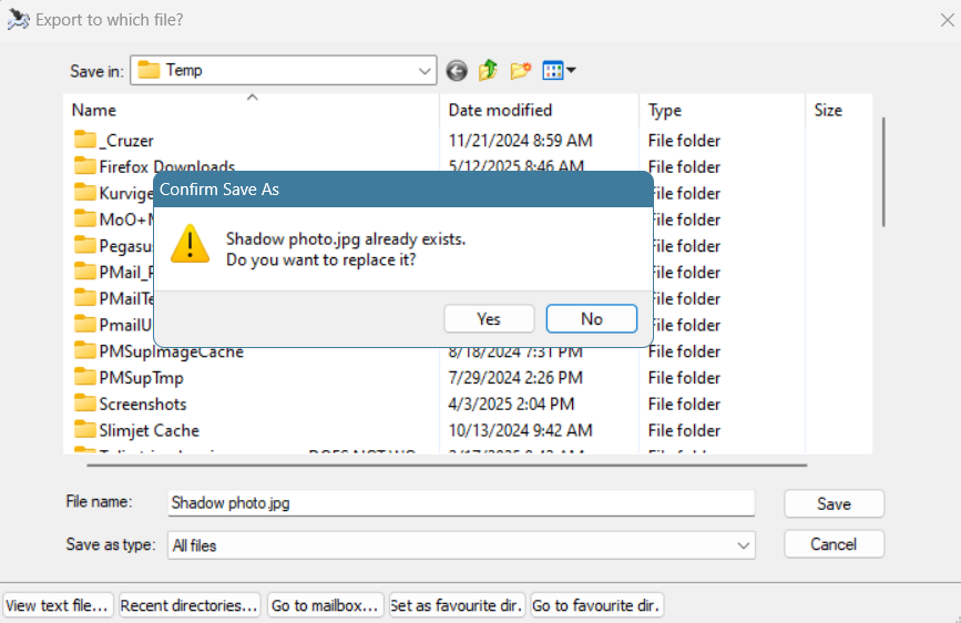

AFAIK, the overwrite warning is a system warning. I receive it when saving attachments. Unfortunately, I don't have any advice about why it is not working for you.

I've just re-checked this. It is true, that often this warning appears: if you copy a single attachment or a bunch of attachments when the first is a duplicate.
But if only the second, third and so on are, or if you answer "yes" for overwriting the first, the rest is being overwritten without warnings.
So it seems, that the PM/system interface checks only the first file and assumes that the rest needn't be checked.

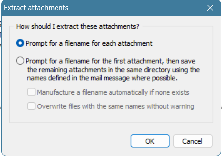

When I select multiple attachments to save I receive this Extract Attachments window asking for instructions. When I select the first option I am notified about the overwrite at each file save prompt. I can only see the second option with "overwrite" enabled as a way to produce what you describe. That is pretty obvious though so I don't know what could be causing the behavior you describe.

I have just done some more testing and think I might have duplicated what you describe.
When I selected the option to "Prompt for a filename for each attachment" I was prompted for overwrite approval for each attachment as it was processed.
When I selected the option to " Prompt for a filename for the first attachment,..." I was prompted for overwrite approval for the first attachment only, the others were overwritten. Is this option the one you are using?

Yes, that's it. It happens sometimes, that the first attachment in the message is not-duplicated, but the other ones are. Or, rarely, that I acknowledge overwriting the first, but wouldn't approve overwriting of the rest, if I had a chance to decide.
