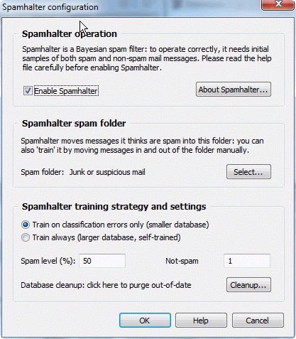

I use train on errors only choice. Train always may speed training but on my daily use I couldn't confirm that. The other settings will instruct SpamHalter to be more severe or more concealing. IIRC these settings of mine are not SH's defaults.

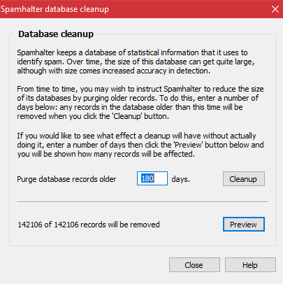

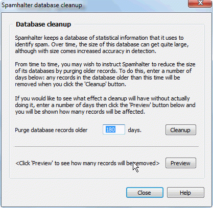

I also use the 180 days purge. Please note that this purge is not automatic. You're only informing that you'll remove data older than 180 days on Cleanup button click. Talking about this with Lukas, he told me too much old data can compromise SH efficiency as spam changes very frequently. I have a 180-day reminder to check SH and eventually clean its old data.

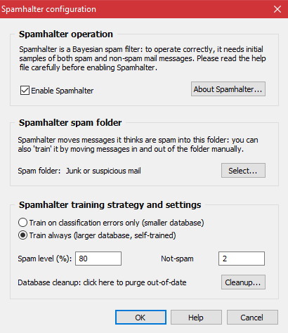

My Spamhalter use is similar to Euler's except I have Spam level % at 80 and Not-spam at 2. I train by drag-n-drop from or to the NMF and Junk folder. Training using the traffic signal icon did not appear to work. These are my statistics:

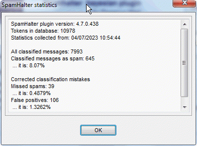

SpamHalter plugin version: 4.7.0.438
Tokens in database: 33508
Statistics collected from: 1/14/2019 7:20:04 PM
All classified messages: 35286
Classified messages as spam: 8443
... it is: 23.93%
Corrected classification mistakes
Missed spams: 1621
... it is: 4.5939%
False positives: 577
... it is: 1.6352%

6845777667cbc
I then restarted Pegasus and checked the Spamhalter stats. I ended up with more records than I had before. What did I do wrong?
684576531c10e
6845768666c30
I shut down Pegasus and loaded the starter Spamhalter database from here http://www.vandenbogaerde.net/files/words4.zip I renamed the existing words4.db3 to words4_old.db3 ![6845777667cbc](serve/attachment&path=6845777667cbc) I then restarted Pegasus and checked the Spamhalter stats. I ended up with more records than I had before. What did I do wrong? ![684576531c10e](serve/attachment&path=684576531c10e) ![6845768666c30](serve/attachment&path=6845768666c30)
Likely nothing. The starter database is pretty good size. I just loaded it and the statistics show that it contains 142106 tokens whereas a new one shows 80 tokens. You don't need to use the starter database. You can start with a clean one and then train Spamhalter using just your data per the instructions in the Spamhalter > Help button. To start with a clean one, just rename or delete words.db3. A new one will be created as soon as you go into Spamhalter configuration.

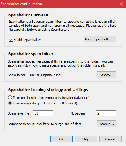

So I turned on SpamHalter about 2 weeks ago with a clean database and the "Train Always" option. I have also been training it manually by specifically classifying messages and moving from inbox to junk folder. SH appears to have been accumulating records since then but there are several messages from the same sender that it consistently misses. How long does it take for SH to recognize them as spam?

So I turned on SpamHalter about 2 weeks ago with a clean database and the "Train Always" option. I have also been training it manually by specifically classifying messages and moving from inbox to junk folder. SH appears to have been accumulating records since then but there are several messages from the same sender that it consistently misses. How long does it take for SH to recognize them as spam? Also, not to beat a dead horse, but the connectivity and filter issues have not gone away either. Just FYI, I'm running with Polling Controls set at 3600 seconds, I accumulate 20-30 messages (sometimes more) in NMF over 24 hours. When I open the NMF, filtering starts and takes 60-90 seconds (I've timed it) to complete! I have a couple theories why. I run Avast security software and it also checks mail content because occasionally I get a message that it quarantined a malware infested message. Could that be interfering with Pegasus mail filtering? Second, I have a SSD hard drive and from what I have read, that can slow down over time. I've had it installed for maybe 5 years now and although it's only about 45% full, because of the nature of how SSD works I'm thinking it could be contributing to the slow filter time. Any thoughts?
There are some messages that SH seems to ignore. When a message moved to the spam folder, comes back again as ham, first I reclassify it as spam: either click the "traffic light" in the message reader and select it as spam, OR right-click the message in the folder list and pick Spam classification > Train message(s) as spam AND then move the message(s) to the spam folder.
