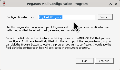

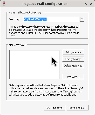

Some thoughts on this...
  1. When backing up Pegasus Mail I suggest backing up the entire C:\PMAIL directory so that you have entire installation which will include the .CFG file in \Programs, the user data in \MAIL and the mailbox directory(ies) in \MAIL.
  2. Removing a Windows user and then creating a new on should not affect the Pegasus Mail installation unless you intend to reformat the drive and do a new Windows installation.
  3. There is a white paper available on this sight that contains instructions on how to copy just backed-up mailbox data to a clean installation. That is a last ditch effort though. As you know, C:/PMAIL/MAIL/<my_user> contains most of the configuration files. Problems with Pegasus Mail are usually associated with one of those files so if in your mind "restore" means copying the entire content of a mailbox directory to a new installation of Pegasus Mail, well, that rarely fixes a problem.
FWIW, I believe rebuilding HIERARCH.PM would be worthwhile before giving up on the current installation entirely.
