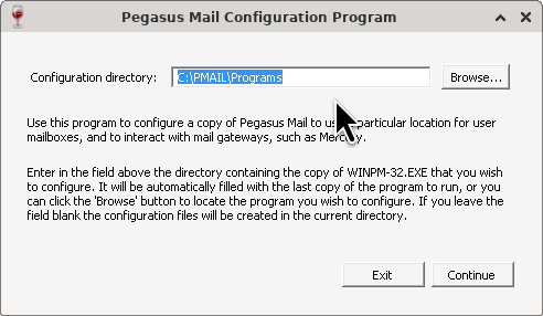

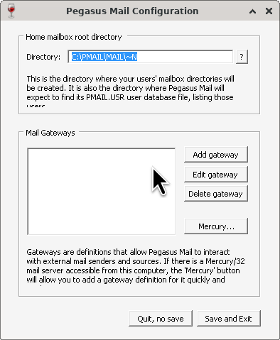

Did some test.
If one opens the PMAIL.CFG file in notepad, and saves it all the NULL characters are changed to Spaces.
Tried opening it with PCONFIG32.EXE and saving it, but it didn't change the spaces back to NULL as is standard with C variables.
Found removing the PMAIL.CFG file and then running PCONFIG32.EXE and entering default values from earlier images will recreated the file with NULLs.
Only difference it that origina PMAIL.CFG File has octal byte 133 as 00 instead of original 02.
Don't know what that byte does?
Also, note original size of PMAIL.CFG is 512bytes, but PCONFIG32.EXE seems to created it as 1024 with just extra nulls.
Did some test. If one opens the PMAIL.CFG file in notepad, and saves it all the NULL characters are changed to Spaces. Tried opening it with PCONFIG32.EXE and saving it, but it didn&#039;t change the spaces back to NULL as is standard with C variables. Found removing the PMAIL.CFG file and then running PCONFIG32.EXE and entering default values from earlier images will recreated the file with NULLs. Only difference it that origina PMAIL.CFG File has octal byte 133 as 00 instead of original 02. Don&#039;t know what that byte does? Also, note original size of PMAIL.CFG is 512bytes, but PCONFIG32.EXE seems to created it as 1024 with just extra nulls.
