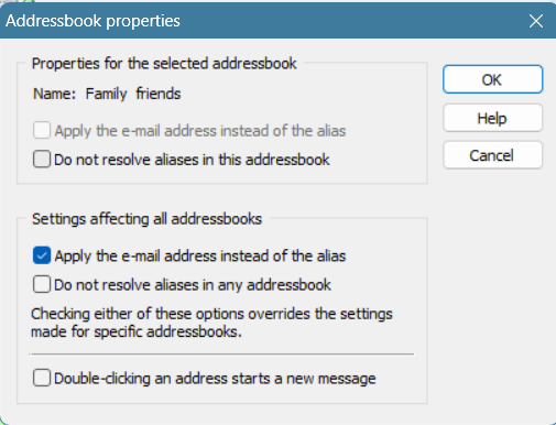

Also, check the aliasing settings. I do not have any 'resolve aliases' options enabled.
6ad2604db098e
Also, check the aliasing settings. I do not have any 'resolve aliases' options enabled. ![6ad2604db098e](serve/attachment&path=6ad2604db098e)
I didn't finish my though in my previous post. The remainder was to enable the option to "Apply the e-mail address instead of the alias" if it isn't already enabled. This will then show you the actual email address in the To field of a new message.
