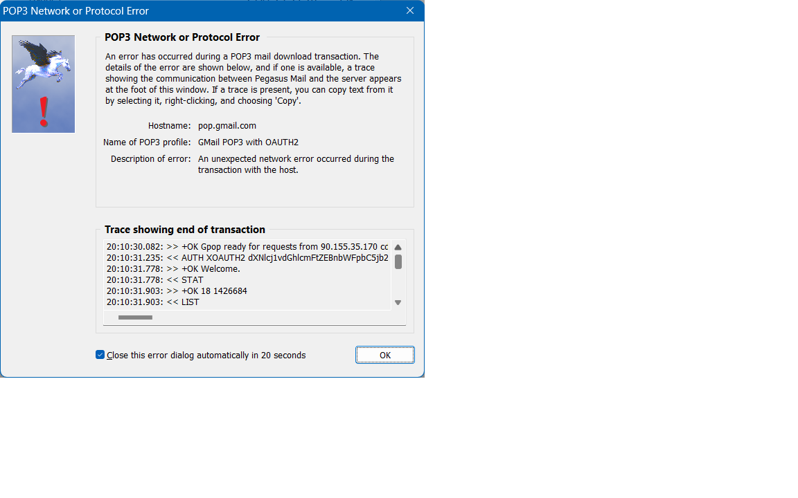

GMail POP3 errors with v4.91
About 3 weeks ago I downloaded Pegasus Mail v4.91.1746 and updated my previous installation of v4.81-pb3 that I'd been running successfully and accessing my various GMail mailboxes using OAUTH2 without any significant issues since v4.81-pb3 was first released in approx Feb 2023.
Although I can't be absolutely certain about the timing, it seems to me that since I installed v4.91 I've regularly been getting POP3 errors when accessing my various GMail mailboxes; the following is the error message that typically appears:

The consequence of the POP3 errors is that the downloads of the 19 messages that are waiting on GMail never seem to complete successfully so the same messages appear again during the next download attempt.
My GMail mailboxes are all configured to archive the messages on GMail after they've been successfully downloaded by PMail; this always seemed to work perfectly well when I was running v4.81-pb3.
Has anyone else encountered any issues of this sort when accessing GMail mailboxes using PMail v4.91?

I tried enabling the Internet session logging and captured a couple of session logs for one of my Gmail mailboxes; the first attempt to download the 18 waiting messages resulted in the session bombing out before even the first message was downloaded, Here's the session log for that attempt:

As the log shows, there seems to be something odd happening with SSL that's causing the connection to be closed by the peer, which is presumably pop.gmail.com.
A (very) short time later a second attempt to download the 18 messages waiting in the mailbox resulted in a few messages being downloaded; here's the final part of the session log for that attempt:

Again this seems to show that the session was closed because of an SSL issue, so the question is what to do to overcome the problem.

I have tried accessing the mailboxes using the web interface - I do it fairly regularly for various reasons - and I haven't noticed anything untoward in any of the mailboxes. I have cleaned out a few emails that have successfully been downloaded by PMail but then didn't get archived in Gmail because the download sessions didn't complete successfully.
As Brian has indicated it does appear that the Gmail server just stops responding in the middle of a session; I don't know how feasible it will be to draw the issue to the attention of the Gmail support team...
I'll try unchecking the option in PMail to delete messages on the server after they've been retrieved to see if that makes any difference.
Martin

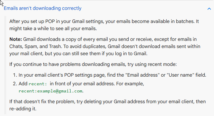

This leads me to wonder if the recent: option is being used.
Good thought Euler. I had forgotten about the recent: option. That is worth a try to see if it changes things although the unanswered questions remains why it had worked fine until recently. The recent: option has been around for years.
[quote=&quot;pid:58124, uid:2194&quot;]This leads me to wonder if the recent: option is being used.[/quote] Good thought Euler. I had forgotten about the recent: option. That is worth a try to see if it changes things although the unanswered questions remains why it had worked fine until recently. The recent: option has been around for years.
