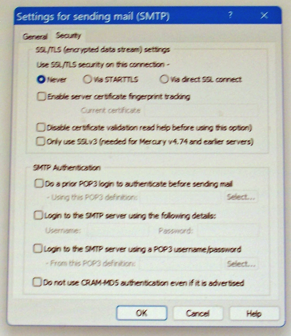

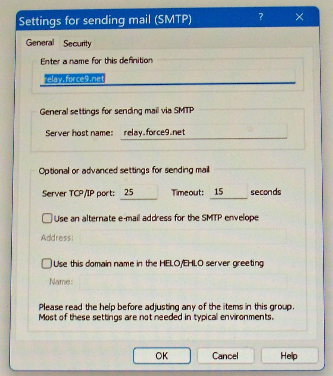

"Are you still using SMTP port 25 instead of port 587?"
Yes. It has been like that since 1998, I have never changed anything since initial set up, screen grabs below. What do I need to change and how?

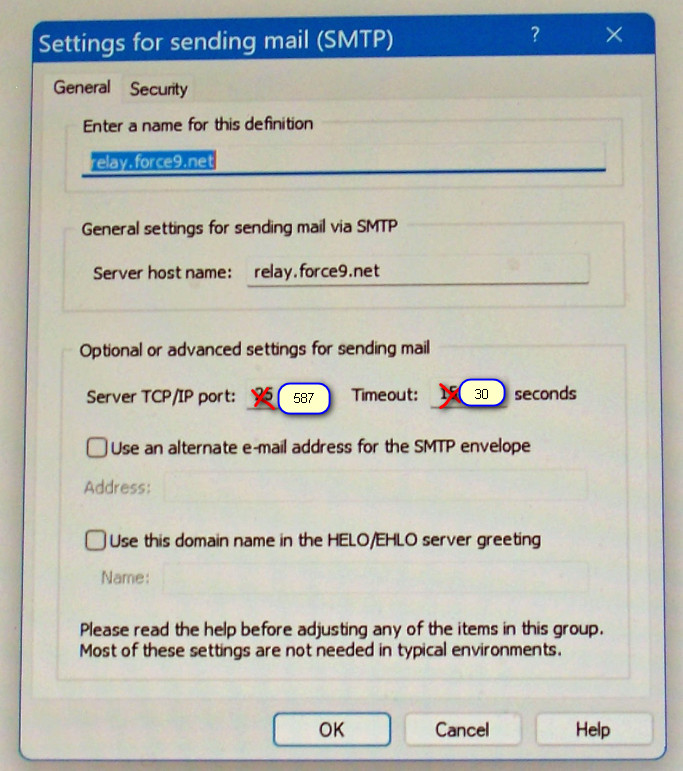

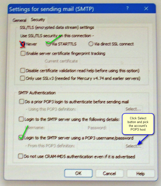

Brian, you'll need to make a couple easy changes. I'm using your images to show it:
68f282268e08d
68f282269a511
The SMTP authentication is important. It's the same login/password you already use to download messages via POP3. Pegasus make it easy for you as you don't have to type it again, just inform host's name used for POP3 access of the mail account.
Brian, you&#039;ll need to make a couple easy changes. I&#039;m using your images to show it: ![68f282268e08d](serve/attachment&amp;path=68f282268e08d) ![68f282269a511](serve/attachment&amp;path=68f282269a511) The SMTP authentication is important. It&#039;s the same login/password you already use to download messages via POP3. Pegasus make it easy for you as you don&#039;t have to type it again, just inform host&#039;s name used for POP3 access of the mail account.
Aside from this, switching to StartTLS or SSL connect will prompt you for changing the port automatically, you just need to verify the proper port number.
