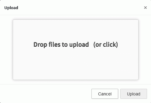

Try clicking the icon inside the red square.
6931f197c4aa2
A pop-up window will appear.
6931f2065c3a4
You can then drag and drop your screenshot into the area or click on it to browse for the corresponding file. Then, just press Upload to send the image to the server. A link to it will appear as part of your message.
Don't forget to post the message.

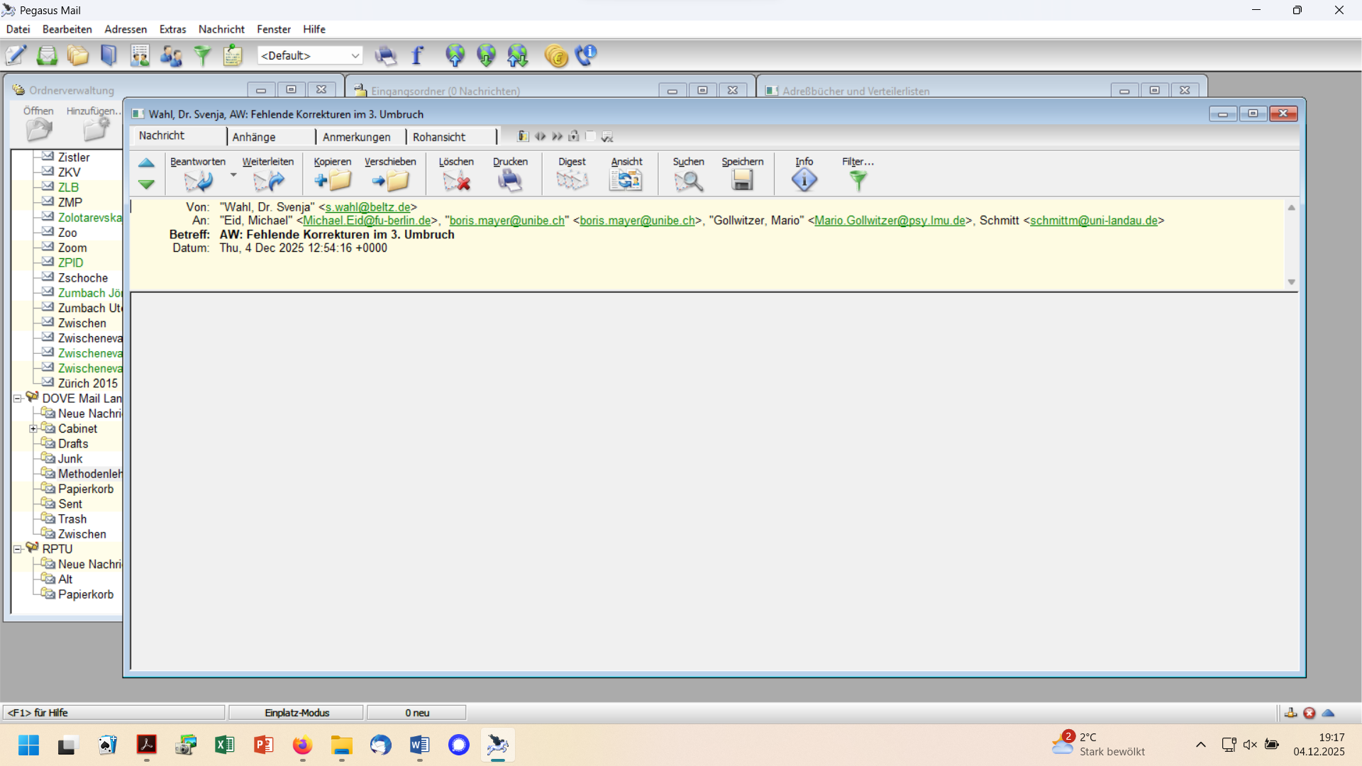

Thank you for your help. Here comes the screenshot.
69328dd5b3f64
Thank you for your help. Here comes the screenshot. ![69328dd5b3f64](serve/attachment&path=69328dd5b3f64)
Looks like an incomplete installation, the advanced HTML renderer is missing. What Windows version are you running?
