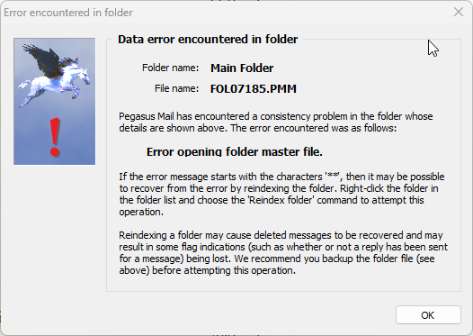

Hi Brian,
I think something abnormal is happening on shutdown - I have to click the X in the top right corner twice to get the whole thing to close.
I went to Main Folder and checked consistency and get the master file error below.
The mail box file is 185 Mb.
I have a lot of CNM files - is this normal?
I can move all the emails69941f7d3da01
from New Mail to Mail Folder manually
Edit I reindexed to Mail Folder and it no longer gives the master file error
Hi Brian, I think something abnormal is happening on shutdown - I have to click the X in the top right corner twice to get the whole thing to close. I went to Main Folder and checked consistency and get the master file error below. The mail box file is 185 Mb. I have a lot of CNM files - is this normal? I can move all the emails![69941f7d3da01](serve/attachment&path=69941f7d3da01) from New Mail to Mail Folder manually Edit I reindexed to Mail Folder and it no longer gives the master file error
Let us know when you have confirmed whether this solved the original problem of read mail not moving automatically
