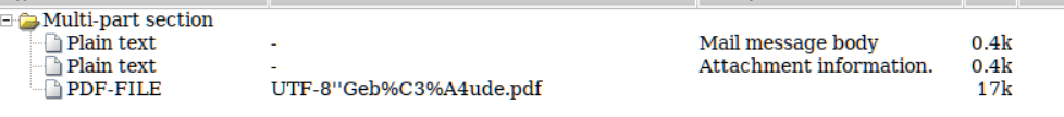

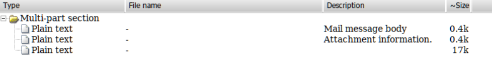

Did some screen of the attachment screens.
69df87aa534db
69df87bb0856d
If I click on attachment with UTF file name it created A4R307RG.pdf file in my user Temp directory and opened it.
With original coding, I can click on the save option and enter a name or use the -.
The file is saved and can open it with viewer. The same and edit option doesn't work to save or open it.
The B.CNM option does work.
Don't know if there is an option that would work to better pass the file name.
Just wanted to test with as little changes as necessary.
Wonder what program originally created the email.
Did some screen of the attachment screens. ![69df87aa534db](serve/attachment&amp;path=69df87aa534db) ![69df87bb0856d](serve/attachment&amp;path=69df87bb0856d) If I click on attachment with UTF file name it created A4R307RG.pdf file in my user Temp directory and opened it. With original coding, I can click on the save option and enter a name or use the -. The file is saved and can open it with viewer. The same and edit option doesn&#039;t work to save or open it. The B.CNM option does work. Don&#039;t know if there is an option that would work to better pass the file name. Just wanted to test with as little changes as necessary. Wonder what program originally created the email.

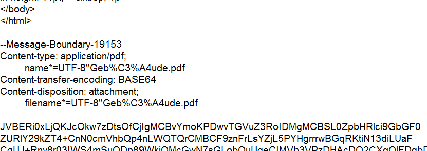

The asterisk is in the original email! Just as I mentioned in the post's subject line. The forum editor must have removed the asterisk. I just ran into the same problem again. An asterisk is a symbol used for italicized text.
Here's a screenshot of the attachment:
69e0f64eb2e82

On could manually edit the CNM file and make same changes.
Used linux sed, but sure there is a similar windows process.
So looks like current parser doesn't like UTF-8 for filenames.

Seems to me the Pegasus Parser doesn't handle UTF-8 convertion correctly with the *=, and if one puts the UTF-8 code in, it treats them as two extended ascii characters.
So, played with a program to actually extract the pdf file and use the correct utf-8 file name. Result works with the test message I got from kuck, but not sure it would work with all version. Actual code I use has a few things that linux required since its base64 doesn't like the DOS CR/LF, so if doing a windows version, that would be removed.
