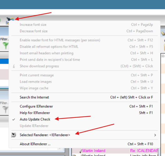

Hugh, IERenderer is the preferred HTML renderer now included with Pegasus Mail. BearHTML is also still included but is no longer being maintained. I mention this because IERenderer has been updated since v4.91 was released so I advise that once you complete the upgrade to 4.91 you make sure IERenderer is enabled and then update it.
6a56443b21310
Hugh, IERenderer is the preferred HTML renderer now included with Pegasus Mail. BearHTML is also still included but is no longer being maintained. I mention this because IERenderer has been updated since v4.91 was released so I advise that once you complete the upgrade to 4.91 you make sure IERenderer is enabled and then update it. ![6a56443b21310](serve/attachment&path=6a56443b21310)

I'm not aware of anyone having such an issue except for you. IOW: Provided you update IER to it's most recent version (2.7.4.0, see Brian's previous reply) and still encounter a link-related issue I need sample messages (forwarded as attachments, please!) to beta-reports[@]pmail.gen.nz !).
