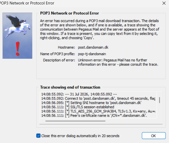

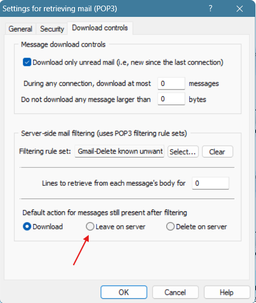

To your comment on the setting "Default action for messages still present after filtering", it is indeed sat to "download", but we have checked all three options, still the same issue.
I did a test, and I think it is time for me to disclose more about my setup. Honestly, everything has been working fine, so it never crossed my mind this might be an issue.
I have installed the Pegasus mail program on my c-drive. To start the program, I have a batch file checking if there is a pmail.ini on a server location (linux system, running samba). If it is found it uses a pmail.cfg file that points to this server location. If not found, it uses another pmail.cfg file which points to the c-drive. Mostly I am working on the server, but every now and then when I travel, I can still work with my emails. I am not using the c-drive side much, as I can VPN into the server.

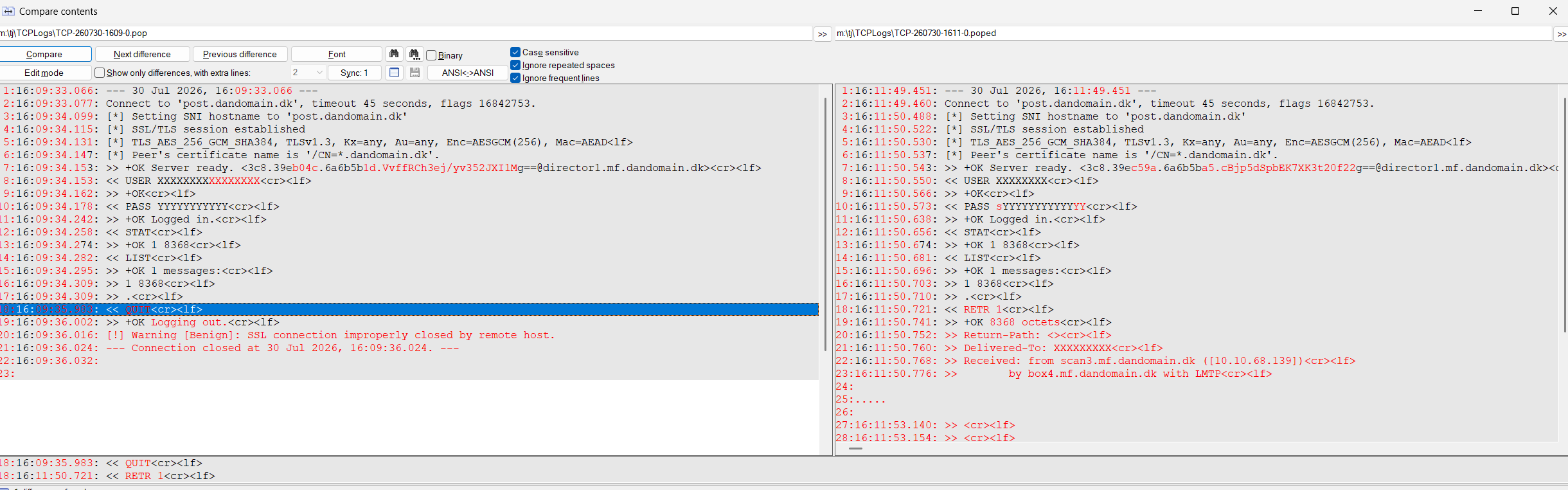

So as a test, I had it pointing to mails on my c-drive, and voilá everything is peachy. Running it pointing to the server, still no dice.
I compared the pnd files, the pmail.ini (I actually copied the one from c to the server) and still the issue persisted.
I have checked for access rights, and all files are accessible to Pegasus.
I did re-create the two cfg files, just in case something had changed, but it did not help.
