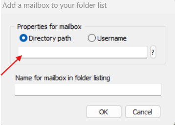

First, thanks for your response. I have created the folder, but where is the "diretory path" button?

It isn't a "button" per se. A radio button is a selector, in this case there are two radio buttons, on for "Directory path" and one for "Username". You can only select one. You must then type the path or the Username in space below the radio buttons.

[quote="pid:59064, uid:40967"]I have created the folder, but where is the "diretory path" button?[/quote] It isn't a "button" per se. A radio button is a selector, in this case there are two radio buttons, on for "Directory path" and one for "Username". You can only select one. You must then type the path or the Username in space below the radio buttons. ![6a6cd2ff82030](serve/attachment&path=6a6cd2ff82030)

Okay; have created a folder. I have added D:\PMAIL\MAIL\ADMIN to use. It took a little looking, but I found it.
