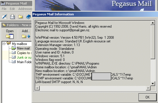

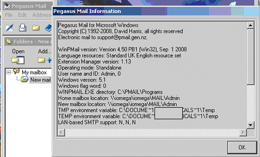

Here are some screenshots to show what's happening:
 First I did a clean install of pegasus on C:, and ended up with the normal main folder containing the welcome message:
Then I moved the mailbox location to the network share, and ended up with this :
 I also used pconfig to manually change the home & new mailbox settings, like so:
Originally, after pegasus installed itself on C:, the mailbox values read: c:\pmail\mail\~N.

It behaves exactly the same. Something else I now noticed is that when using a location on the NAS as mailbox, pegasus will open with a "Welcome to pegasus 4.4. Pegasus has detected that you have previously used an older version of Pegasus on this mailbox" message everytime.
Pegasus must be seeing at least part of the mailbox, because when I deliberately misspell the path, it opens with the "User name please" dialog box. Misspelling the name of a path on the local drive gives the same result.
