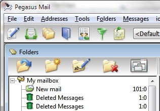

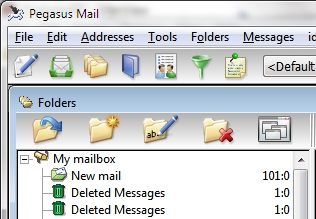

HIERARCH.PM
If you suspect duplicate folders named "Deleted messages" you should look inside HEIRARCH.PM for multiple lines that contain the text "Deleted messages". Here is how:
  1. Double check your folder list for a "Deleted messages" folder. If there, DO NOT PROCEED!
  2. Close Pegasus Mail.
  3. Use a file explorer to navigate to your mailbox directory.
  4. Locate the file named HEIRARCH.PM and make a safety copy. Even better would be to backup the entire mailbox directory but make a safety copy at the very least.
  5. Use Notepad to open the HIERARCH.PM file.
  6. Use the Find function to search for "Deleted messages" (no quotes). Delete and lines that are found. Don't leave any blank lines. Search again, both down and up to insure all entries get searched.
  7. Once you are sure that there are no entries containing "Deleted messages" save the file then close Notepad.
  8. Start Pegasus Mail.
  9. Look at your folder list to make sure it looks normal and that your tray structure (if you had any) remains intact. A problem with the folder list indicates a corruption of some kind occurred during the editing of the HEIRARCH.PM file. Immediately close Pegasus Mail and restore the safety copy.

Here's something I tried (all done in preview mode): I renamed my existing Deleted messages folder containing 5 messages to simply Deleted, then deleted another message and here's what happened:
63533c33589df
IOW: The Deleted folder is gone and another Deleted messages folder has apparently been auto-created, both of them only containing the single newly deleted message after renaming the previous Deleted messages folder, i.e. the five previously deleted messages appear to be gone with the Deleted folder. NB: This is with the "'Deleted messages' folder persists ..." option disabled.
Any further deleted message after the above will go into both of the Deleted messages folders shown above, for the second one (as shown above) counters only being refreshed on click (still in preview mode). Next, after closing and reopening preview, ony a single Deleted messages folder is there and the renamed previous one simply named Deleted is back containing the five previously seemingly lost messages down in the tree hierarchy sorted alphabetically. If restarting Pegasus Mail instead of only closing preview Deleted messages would be completely gone but Deleted with its five messages would be back as well. I assume the closing and reopening preview simulates what would happen with preserving the Deleted messages folder between sessions enabled.
Take home message: Renaming the Deleted messages folder gets you into trouble and shouldn't be done in the first place. And I still believe this is the issue this thread is about ... unless it's some HIERARCH.PM issue ...
