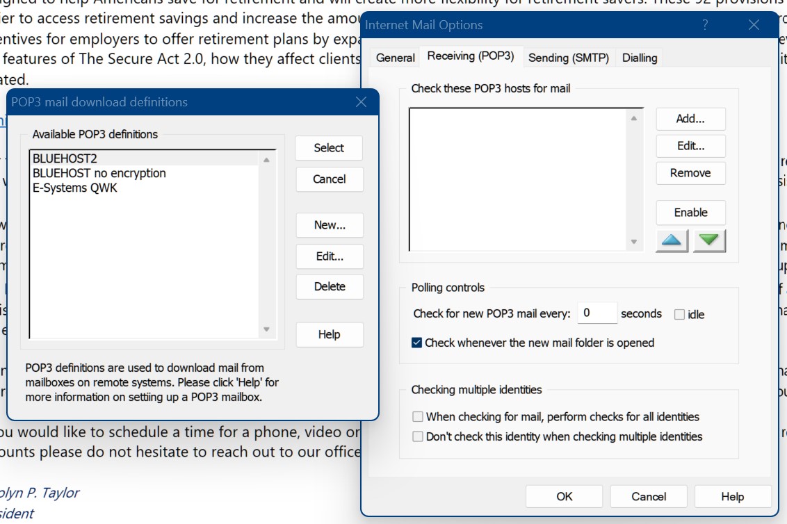

POP3 and SMTP settings getting deleted upon exiting PMail

OK, it has been resolved. To answer @Brian why I have the Home directory seperate from the New Mail directory, indeed, it was not intentional. I have had this setup for a long time, copying files from old PCs to new ones. I have copied the .PND files to the New Mail directory and now all is fine. The definitions are there after exiting and restarting PMAIL. The strange thing is that this was not necessary for older versions of PMAIL. Thanks for your help!!

Did a change of port on my test Jill user, and the one in the moved to directory was changed.
The one in the original C:\PMAIL\MAIL\Jill directory was unchanged.
Just did a test.
In the original C:\PMAIL\MAIL\Jill folder blanked out both PND files
2 Feb 2 11:45 POPWP22Z.PND
2 Feb 2 11:45 SMTDB8XO.PND
just contain CR LF
Started Pegasus 4.81 pb3 and it corrently shows the internet options there, and edit shows info from moved location.
Also, tried making files 0 bytes and still works, so just existence is ok.
Did find that if you remove files, from original directory and start Pegasus the links disappear.
Putting the files back, doesn't restore them. Have to manually add them again, but is just selecting the files after add. All data remains.

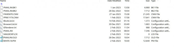

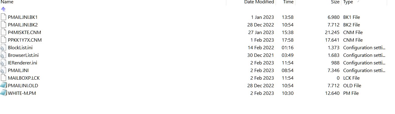

Took the plunge last night and did a fresh install, using the 4.81b2. Forcing all to A:. Looking carefully at what goes where, in my case, this might be an issue: when I look at my current 4.80 backup, these files are in A:\PMAIL\MAIL\ADMIN
63db9d5580578
Everything else related to settings and mail folders is up one level in the A:\PMAIL\MAIL directory
It is a little difficult to tell but it's possible this structure is different in a fresh install. And the 4.81 upgrade might reflect that. In particular, my PMAIL.INI file is in the lower ADMIN subdirectory.
I tried to move a few files up from Admin to the Mail directory, in particular the PMAIL.INI alone, and then also with the 2 CNM files but it did not work. Clearly there are all sorts of dependencies involved that are way beyond my pay grade.
So just guessing here that possibly having transferred Pegasus from 3 computers over the years, the file structure might have changed over time. Fairly certain that with each new PC, I did a one time fresh install, and then just copied the entire MAIL directory (with Admin nested) from a backup to the new machine. Whether or not this was the best way, it has worked flawlessly for easily 10+ years. And certainly the upgrades over the past 5 years when I bought my latest PC has never been a problem.
Only speculating that some change in the upgrade process in 4.81 is not finding or copying a few files from/to their locations as configured on my PC. Again, as this has never been an issue over multiple machines and many years, it's thrown me.
So, one key question is: what files should be in the MAIL\ADMIN directory, vs the MAIL directory?
In my case, at the moment, there are only a few files as you can see in the ADMIN directory. The vast majority of files etc. are one level up. If this is a potential source of the problem, it looks like just moving a few to some more "standard" location might sort this. If I knew precisely which, this might be easily resolved. The obvious suspects: the PMAIL.INI, a few PND files, maybe one or 2 others?
Appreciate the patience and help a number have devoted to this. I'm doing what I can with limited skills. I surely want to resolve this to prepare for eventual release of v 5.0. Thanks
