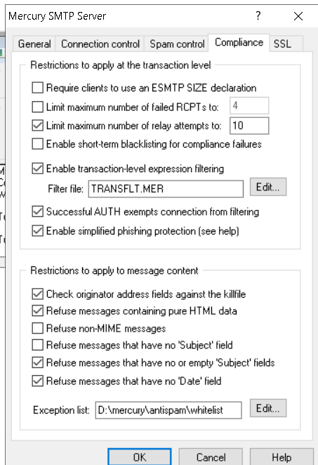

I am unsure right now HOW the filter is applied.
My filter has a rule to drop the connection immediately when the remote server is announcing itself in the HELO command with localhost.
Using now roundcube and it announces itself with localhost AND the user is successful authenticated, the connection is still drop immediately.
The box underneath the filter "Successful AUTH exempts from filtering" is ticked, as shown in the image. But it is not applied to my successful authenticated user.
Do I missunderstand this, or is this not working correctly ?
To test this, I commented out the rule in the transaction filter and the message was send correctly. Activated it again, failure. smile

Hallo Joerg,
I think you misunderstood my point, or I described it not clear enough.
Roundcube and Mercury are working fine with each other. I also found a setting in roundcube's config file to set a HELO for announcing. But so far I hadn't done so and had added my "old" (12 years) transaction filter to Mercury.
And after adding the filter, I noticed the problem and did the testing.
The problem seems to be: the transaction filter is even applied when users are authenticated. Which should not be, if I understand the above described option (image) correct.
So, if I am correct in my understanding by ticking this option, than this is a bug in Mercury.
Maybe Rolf or David can shime in ?
Johannes

Hello Rolf,
did change the rule and, as expected, the user is able to send.
But that does not answer my original question:
By ticking the box "Successful Auth exempts from filtering", as shown in my image above, a user should be able to send mail, even if the rule is set to H, "localhost", DS, "554 localhost". The transaction filter is not applied in the situation that the user has authenticated successfuly in MercuryS. Is that correct understood ?
Assuming, that it is correct understood by me, than using the D operation in this situation is just "helping to overcome" the error. And the error is, that the filter is applied even if the box "Successful Auth exempts from filtering" is ticked.

No error. The 'H' rule terminates the connection directly when the EHLO line is processed, so there is no AUTH attempt.
No error. The &#039;H&#039; rule terminates the connection directly when the EHLO line is processed, so there is no AUTH attempt.
Hello Rolf,
I see and I know that this is no error of the transaction filter. The transaction filter itself is working correct.
The question what I am asking is, does the box "Successful Auth exempts connection from filtering" applies to the transaction filter or not.
According to the Help, one can argue it does.
Successful AUTH exempts connection from filtering
If you enable SMTP Authentication then you may wish to allow connections that have successfully authenticated themselves to bypass the compliance tests on this page - to do that, check this control. When this control is checked, MercuryS applies a much smaller range of tests to the connection, making it easier for authenticated users to send mail.
That is all what I would like to find out. It seems it,s not, but is that correct ?

To understand this it's necessary to have a closer look at how an SMTP transaction works. It's a dialog between the connecting client and the server with a number of specified steps. The first step is the HELO/EHLO greeting. If a connection is terminated already at that stage there will simply never be any AUTH attempt, successful or otherwise.
The 'D' rule allows the possibility to wait for an AUTH attempt before deciding on if the connection should be refused or not.
