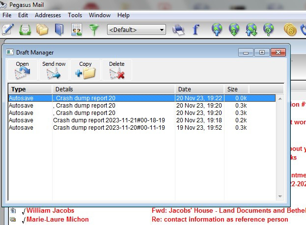

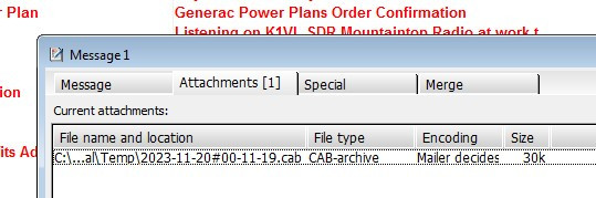

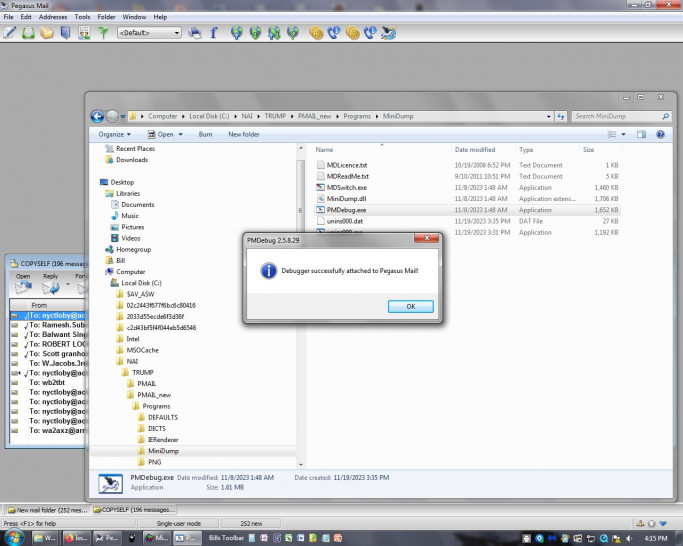

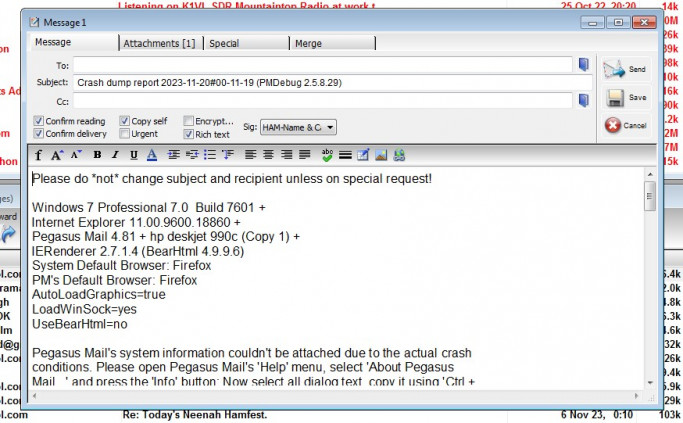

I was able to use my Pegasus mail to send eight .dmp files to beta-report[at]pmail.gen.nz, obtained from .cab files that were generated via PMDebug Snapshot over the past few days when my Pegasus mail hangs while trying to shutdown. Please let me know if the attachments were received OK.
As mentioned previously, after forcing shutdown with Task manager and reopening Pegasus mail, only then do the emails down-loaded in the previous session appear in my Inbox.
I hope the attached files will help with a fix for my Pegasus mail.

Ok, first I have to apologize to Mike, he was right with his assumption regarding this subject above (and thanks for your ideas as well, Brian): It's new mail filtering apparently causing an infinite loop which can only be terminated via task manager.
When looking at the very first dump I did it on Windows 10, and apparently (something I wasn't prepared to see) this had a misleading effect on the stack trace I saw. Now, after opening a couple of more dumps on Windows 7 (i.e. your system, Bill) it's very clear that Pegasus Mail is working on new mail filtering when being terminated during the hang, in case you want to get an idea of what I'm seeing, here's a sample case (to be read from bottom up):
winpm_32!fm_getc(long id = 1)
winpm_32!fm_get_folded_line(long fil = 1, char * line = 0x... "To: ...
winpm_32!get_header(long fil = 1, char * str = 0x... "To: ...
winpm_32!check_rules(struct IMESSAGE ...
winpm_32!apply_rules(struct LIST ...
winpm_32!apply_newmail_rules(struct LIST ...
winpm_32!browse_proc(struct HWND ...
What you can tell from the above function calls is that Pegasus Mail executes a new mail filter rule on the To: header line. So if you already have an idea of the line being affected you may simply disable it or disable the whole rule set (if you don't remember where to find it see the screen shot below). I'll also send you (via mail message) a more detailed version of the call stack containing the contents of the rule being applied (or, if there are different ones in different dumps, several ones) so you can better locate them).
