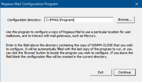

- Use a file explorer to navigate it to C:\PMAIL\Programs. Locate PCONFIG32.EXE and double-click on it to run it.
The first screen is for the path to the programs files. Confirm that this is C:\PMAIL\Programs. If confirmed, click Continue

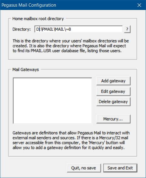

The next screen is where you specify the new path to the root mailbox directory. You should see the path C:\PMAIL\MAIL\ suffixed with either "~8" or "~N". Change the "C" to a "D". Confirm that the path is now D:\PMAIL\MAIL\ suffixed with either "~8" or "~N".
Ignore the Mail Gateways section.
Click Save and Exit.
That's it! Pegasus Mail should use the new mailbox location the next time it starts. Once started, go to Help > About Pegasus Mail > Info button and confirm that the path displayed for the Home and New mailbox locations is D:\PMAIL\MAIL\mdod.

3. Use a file explorer to navigate it to C:\PMAIL\Programs. Locate PCONFIG32.EXE and double-click on it to run it.
