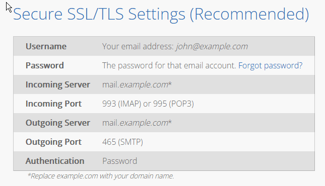

Looking at Bluehost's instructions, I found them to be pretty straightforward. However, they are ambiguous about which ports and security protocols to use, probably because they accept both. By default, an SMTP connection uses port 465 for SSL or port 587 for STARTTLS. They also accept port 26 without encryption. What are your parameters?
![685ad283160b1](serve/attachment&path=685ad283160b1) Looking at Bluehost's instructions, I found them to be pretty straightforward. However, they are ambiguous about which ports and security protocols to use, probably because they accept both. By default, an SMTP connection uses port 465 for SSL or port 587 for STARTTLS. They also accept port 26 without encryption. What are your parameters?
