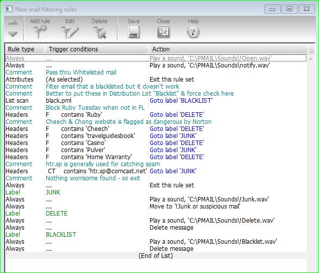

  1. The global whitelist is checked early in the filtering sequence, but it seems that it only sets the attribute for the individual email. See my filtering code, where I check the attribute & exit if it's set. Please verify that this is correct.

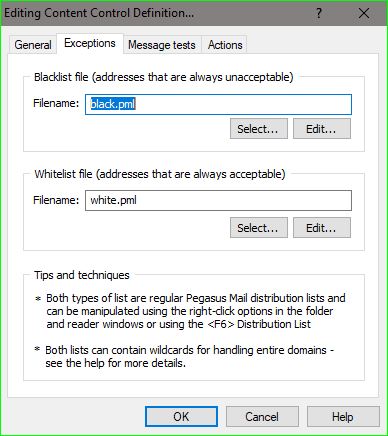

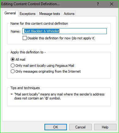

  2. There is another whitelist referenced in the Content Control Exceptions (see screenshot). This seems to reference a distribution list file which can be specific to the content control definition. Do I need another whitelist attribute rule to check this or use a List Scan in my filter or what?
  3. The Blacklist is only referenced in the Content Control Definition. Can it have only exact email addresses (what's between the angle brackets> or does it do a "contains" text match filter? The Help says that if you want to exclude an entire domain, you can put -\MATCH *@domainname.comin the file. What about matching text outside the angle brackets?
  4. Does the Blacklist filename (& the whitelist) need a "@" in front of it. Does it need it only when being referenced in a rule?
What you have 'should' work but if have never tried it. I propose this test to see if it is working: Change rule action from "Always exit" to change color then see if the color gets changed when a message from a whitelisted source arrives. If it doesn't, check the message properties to see the "Is Whitelisted" property is ticked. If neither, then the problem would appear to be in the whitelist itself.
This is the only whitelist that I know of. What is the other one you see?

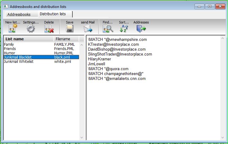

Where did you see the reference to "-\Match"? I don't see it in the manual or the Content Control help content. Best I can tell from the documentation, only email addresses or domains using the asterisk wildcard are acceptable. Perhaps another forum member knows more about this.

I 5. "List Scan" the blacklist file in my filter (see screenshot), but it seems that may be unnecessary if it's already done by the content control.
Correct. Also, think about this. If the Content Control blacklist moves a message to Junk then it will never be processed through the new mail filter.
[quote="pid:57824, uid:28362"]1. The global whitelist is checked early in the filtering sequence, but it seems that it only sets the attribute for the individual email. See my filtering code, where I check the attribute & exit if it's set. Please verify that this is correct.[/quote] What you have 'should' work but if have never tried it. I propose this test to see if it is working: Change rule action from "Always exit" to change color then see if the color gets changed when a message from a whitelisted source arrives. If it doesn't, check the message properties to see the "Is Whitelisted" property is ticked. If neither, then the problem would appear to be in the whitelist itself. [quote="pid:57824, uid:28362"]2. There is another whitelist referenced in the Content Control Exceptions (see screenshot). This seems to reference a distribution list file which can be specific to the content control definition. Do I need another whitelist attribute rule to check this or use a List Scan in my filter or what?[/quote] This is the only whitelist that I know of. What is the other one you see? [quote="pid:57824, uid:28362"]3. The Blacklist is only referenced in the Content Control Definition. Can it have only exact email addresses (what's between the angle brackets> or does it do a "contains" text match filter? The Help says that if you want to exclude an entire domain, you can put -\MATCH *@domainname.comin the file. What about matching text outside the angle brackets?[/quote] Where did you see the reference to "-\Match"? I don't see it in the manual or the Content Control help content. Best I can tell from the documentation, only email addresses or domains using the asterisk wildcard are acceptable. Perhaps another forum member knows more about this. [quote="pid:57824, uid:28362"]4. Does the Blacklist filename (& the whitelist) need a "@" in front of it. Does it need it only when being referenced in a rule?[/quote] The "'@" is not part of the filename. It gets added when creating the rule. I don't know why. [quote="pid:57824, uid:28362"]I 5. "List Scan" the blacklist file in my filter (see screenshot), but it seems that may be unnecessary if it's already done by the content control.[/quote] Correct. Also, think about this. If the Content Control blacklist moves a message to Junk then it will never be processed through the new mail filter.
Concerning this screenshot...
686c52901938e
...the \MATCH can be ignored without a proper ending. Usually, a "*" following the partial address will do. As an example, the first one should be:
\MATCH *@vrnewhampshire.com*
Concerning this screenshot... ![686c52901938e](serve/attachment&path=686c52901938e) ...the \MATCH can be ignored without a proper ending. Usually, a "*" following the partial address will do. As an example, the first one should be: ```` \MATCH *@vrnewhampshire.com* ````

Your suggestion of changing the color of the message to trace its processing during filtering is a good one. I tried that and the global whitelist attribute does work correctly. I had been using the playing of sounds, but that doesn't seem to work reliably.
I am now also using changing the color of the message for other filtering flags - such as junk & blacklisted mail. Very useful.
The blacklist I reference in my Content Control definition doesn't seem to work, but that may be because I have no content processing rules file defined. I'm trying to use just the Blacklist & Whitelist. List Scanning that Blacklist file in my new mail filter does work. When I edit the Whitelist file using the Content Control editor, there is nothing in the file, yet the Global Whitelist has hundreds of entries. I can't explain that, except that maybe the 2 Whitelists are separate.
You can find a description of the \MATCH command in the Help under "Filtering Rules, list membership matching".
