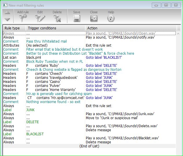

Your suggestion of changing the color of the message to trace its processing during filtering is a good one. I tried that and the global whitelist attribute does work correctly. I had been using the playing of sounds, but that doesn't seem to work reliably.
I am now also using changing the color of the message for other filtering flags - such as junk & blacklisted mail. Very useful.

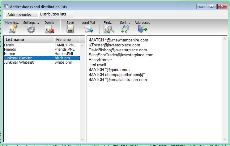

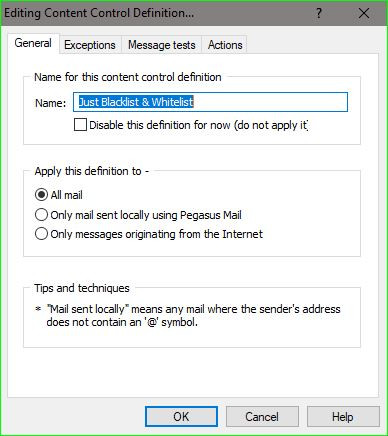

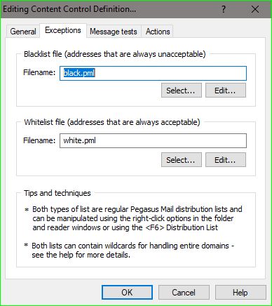

The blacklist I reference in my Content Control definition doesn't seem to work, but that may be because I have no content processing rules file defined. I'm trying to use just the Blacklist & Whitelist. List Scanning that Blacklist file in my new mail filter does work. When I edit the Whitelist file using the Content Control editor, there is nothing in the file, yet the Global Whitelist has hundreds of entries. I can't explain that, except that maybe the 2 Whitelists are separate.
You can find a description of the \MATCH command in the Help under "Filtering Rules, list membership matching".

BTW, I do have a somewhat detailed filter which runs when the New Mailbox is closed. It catches my bills & puts them in a special folder. It works really well & helps make sure I don't miss any bills, since I get most of them by email.
