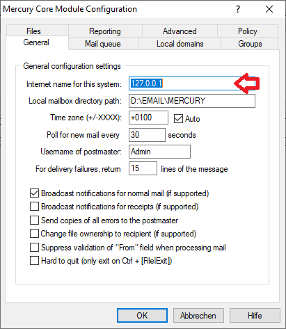

By "Set servername to something that makes sense, like mailserver or mercury", I presume you mean this setting:
6355e5cd740b5
Just using "127.0.0.1" seems to work just as well for me. I know I made a mistake in that example by omitting "~N" in the mailbox path, which I already corrected.
