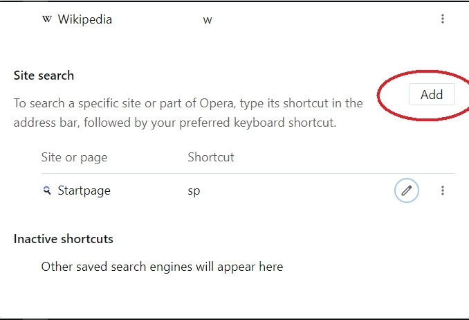

I added Startpage as my favorite search machine but couldn't get it to replace Ggl, all the built-in machines are greyed out (i.e. their options) and so is the option to set Startpage as default so I can only set it up as an additional search machine. And the Startup homepage doesn't offer any other options than to set Startpage as the browser's homepage with Ggl still being the default search machine. Do I miss anything?

Michael, it appears that you were able to add Startpage as a search engine but not set it as a favorite. I wasn't even able to add it as search engine. Interestingly, in Slimjet, startpage.com displays a "Add to Chrome" button. This is not the case in Opera. Other search engines in Opera were not greyed out for me. I was able to change the default engine to DuckDuckGo.

I was not able to add Startpage as search engine in my Opera. Interestingly, in my Slimjet browser, the startpage.com website displays a "Add to Chrome" button. This not happen when it is accessed with Opera. not the case in Opera. Other search engines in Opera were not greyed out for me. I was able to change the default engine to DuckDuckGo.

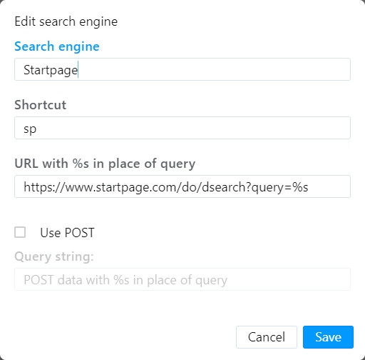

Yes, you can select any of the preinstalled search machines as default but not a newly added one, here's how it goes (the hint shown there is actually misleading, it's not about site search and I don't even understand what they are trying to say there at all ("search a part of Opera"???):
6460037cb6b98
In the edit dialog you enter the following text to get it working:
646003d5d5156
