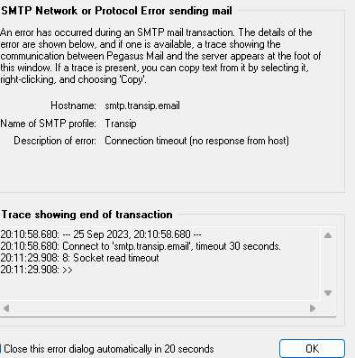

I switched e-mail provider and I cant mail using their smtp server. When trying to mail I get an error stating Connection timeout. Socket read timeout. See attached screenshot
According to my provider I need to use TLS 1.2 but I cant find that option in Pegasus.
Help??
I have been using Pegasus very happily for 30 years or so, I dont really want to switch.
Harry van Horen
65129cf36ef0e
Hi I switched e-mail provider and I cant mail using their smtp server. When trying to mail I get an error stating Connection timeout. Socket read timeout. See attached screenshot According to my provider I need to use TLS 1.2 but I cant find that option in Pegasus. Help?? I have been using Pegasus very happily for 30 years or so, I dont really want to switch. Harry van Horen ![65129cf36ef0e](serve/attachment&path=65129cf36ef0e)

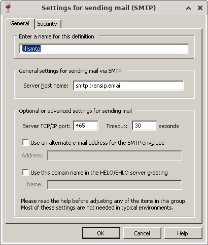

What port to you have Pegasus setup to use
The old standard port 25 that was the unencrypted port isn't available,
but it is showing 465 and 587 available?

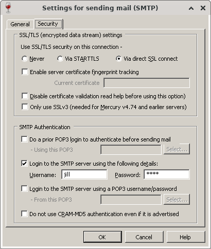

Then tried to send an email to myself, but of course it fails since don't have an account on that system, but the log file shows that it connnected fine. This is a dummy account jill, so password is not a real password..
21:14:12.205: --- 26 Sep 2023, 21:14:12.205 ---
21:14:12.206: Connect to 'smtp.transip.email', timeout 30 seconds, flags 16842753.
21:14:13.223: [] Setting SNI hostname to 'smtp.transip.email'
21:14:13.763: [
] SSL/TLS session established
21:14:13.768: [] ECDHE-RSA-AES128-GCM-SHA256, TLSv1.2, Kx=ECDH, Au=RSA, Enc=AESGCM(12smile, Mac=AEAD<lf>
21:14:13.769: [
] Peer's certificate name is '/CN=.transip.email'.
21:14:14.565: >> 220 submission8.mail.transip.nl ESMTP<cr><lf>
21:14:14.573: << EHLO [192.168.10.100]<cr><lf>
21:14:14.837: >> 250-submission8.mail.transip.nl<cr><lf>
21:14:14.838: >> 250-PIPELINING<cr><lf>
21:14:14.838: >> 250-SIZE 37033449<cr><lf>
21:14:14.838: >> 250-AUTH PLAIN LOGIN<cr><lf>
21:14:14.839: >> 250-AUTH=PLAIN LOGIN<cr><lf>
21:14:14.839: >> 250-ENHANCEDSTATUSCODES<cr><lf>
21:14:14.839: >> 250-8BITMIME<cr><lf>
21:14:14.840: >> 250 DSN<cr><lf>
21:14:14.897: << AUTH LOGIN<cr><lf>
21:14:15.163: >> 334 VXNlcm5hbWU6<cr><lf>
21:14:15.163: << amlsbA==<cr><lf>
21:14:15.438: >> 334 UGFzc3dvcmQ6<cr><lf>
21:14:15.438: << amlsbA==<cr><lf>
21:14:17.199: >> 535 5.7.8 Error: authentication failed: UGFzc3dvcmQ6<cr><lf>
21:14:25.929: << QUIT<cr><lf>
21:14:26.194: >> 221 2.0.0 Bye<cr><lf>
21:14:26.197: [
] OpenSSL secure session normally terminated.
21:14:26.198: --- Connection closed at 26 Sep 2023, 21:14:26.198. ---
21:14:26.198:
But seems to show the site does make an TLS 1.2 connection with no problem.
Didn't try the other port.
![6512bec185016](serve/attachment&amp;path=6512bec185016) ![6512bf008be6d](serve/attachment&amp;path=6512bf008be6d) Then tried to send an email to myself, but of course it fails since don&#039;t have an account on that system, but the log file shows that it connnected fine. This is a dummy account jill, so password is not a real password.. 21:14:12.205: --- 26 Sep 2023, 21:14:12.205 --- 21:14:12.206: Connect to &#039;smtp.transip.email&#039;, timeout 30 seconds, flags 16842753. 21:14:13.223: [*] Setting SNI hostname to &#039;smtp.transip.email&#039; 21:14:13.763: [*] SSL/TLS session established 21:14:13.768: [*] ECDHE-RSA-AES128-GCM-SHA256, TLSv1.2, Kx=ECDH, Au=RSA, Enc=AESGCM(128), Mac=AEAD&lt;lf&gt; 21:14:13.769: [*] Peer&#039;s certificate name is &#039;/CN=*.transip.email&#039;. 21:14:14.565: &gt;&gt; 220 submission8.mail.transip.nl ESMTP&lt;cr&gt;&lt;lf&gt; 21:14:14.573: &lt;&lt; EHLO [192.168.10.100]&lt;cr&gt;&lt;lf&gt; 21:14:14.837: &gt;&gt; 250-submission8.mail.transip.nl&lt;cr&gt;&lt;lf&gt; 21:14:14.838: &gt;&gt; 250-PIPELINING&lt;cr&gt;&lt;lf&gt; 21:14:14.838: &gt;&gt; 250-SIZE 37033449&lt;cr&gt;&lt;lf&gt; 21:14:14.838: &gt;&gt; 250-AUTH PLAIN LOGIN&lt;cr&gt;&lt;lf&gt; 21:14:14.839: &gt;&gt; 250-AUTH=PLAIN LOGIN&lt;cr&gt;&lt;lf&gt; 21:14:14.839: &gt;&gt; 250-ENHANCEDSTATUSCODES&lt;cr&gt;&lt;lf&gt; 21:14:14.839: &gt;&gt; 250-8BITMIME&lt;cr&gt;&lt;lf&gt; 21:14:14.840: &gt;&gt; 250 DSN&lt;cr&gt;&lt;lf&gt; 21:14:14.897: &lt;&lt; AUTH LOGIN&lt;cr&gt;&lt;lf&gt; 21:14:15.163: &gt;&gt; 334 VXNlcm5hbWU6&lt;cr&gt;&lt;lf&gt; 21:14:15.163: &lt;&lt; amlsbA==&lt;cr&gt;&lt;lf&gt; 21:14:15.438: &gt;&gt; 334 UGFzc3dvcmQ6&lt;cr&gt;&lt;lf&gt; 21:14:15.438: &lt;&lt; amlsbA==&lt;cr&gt;&lt;lf&gt; 21:14:17.199: &gt;&gt; 535 5.7.8 Error: authentication failed: UGFzc3dvcmQ6&lt;cr&gt;&lt;lf&gt; 21:14:25.929: &lt;&lt; QUIT&lt;cr&gt;&lt;lf&gt; 21:14:26.194: &gt;&gt; 221 2.0.0 Bye&lt;cr&gt;&lt;lf&gt; 21:14:26.197: [*] OpenSSL secure session normally terminated. 21:14:26.198: --- Connection closed at 26 Sep 2023, 21:14:26.198. --- 21:14:26.198: But seems to show the site does make an TLS 1.2 connection with no problem. Didn&#039;t try the other port.
The SMTP configuration file it created is:
cat SMTDB8XO.PND
Pegasus Mail SMTP definition, 26 Sep 2023, 21:13:42
Title : jillsmtp
Type : SMTP
Flags1 : 2048
Flags2 : 0
Timeout : 30
Port : 465
Host : smtp.transip.email
Username : jill
Password : SEED$31143:"]#i="
Mailbox :
SSLMode : 2
Max_Msgs : 0
So, if you have a file in your mail directory, what does it have.
Note: Change the password line or remove it. In this case it is a dummy line, so didn't matter.
The SMTP configuration file it created is: cat SMTDB8XO.PND # Pegasus Mail SMTP definition, 26 Sep 2023, 21:13:42 Title : jillsmtp Type : SMTP Flags1 : 2048 Flags2 : 0 Timeout : 30 Port : 465 Host : smtp.transip.email Username : jill Password : SEED$31143:&quot;]#i=&quot; Mailbox : SSLMode : 2 Max_Msgs : 0 So, if you have a file in your mail directory, what does it have. Note: Change the password line or remove it. In this case it is a dummy line, so didn&#039;t matter.
Hi
thank you for your reply.
I set up the smtp as they instructed me, with port 465, and that didnt work. They didnt tell me about the authentication, so I'm going to try that now.
Harry
Hi thank you for your reply. I set up the smtp as they instructed me, with port 465, and that didnt work. They didnt tell me about the authentication, so I&#039;m going to try that now. Harry
Hi
thank you very much... it is now working perfectly.
Harry
Hi thank you very much... it is now working perfectly. Harry
