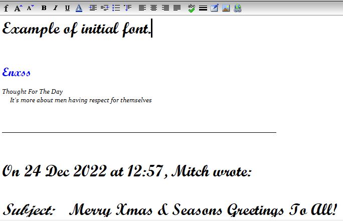

Hello the Forum,
I have an odd issue that has recently arisen, it only happens some of the time apparently for specific messages only. Sometimes, and for certain emails received, when I click Reply and have the option ticked "For replies to HTML, preserve original's format", the original message in my reply is shown with a blue background.
I get around this "blueness" by disabling the afore-mentioned option, so it's not a huge problem, but I'd like to know if it's only me (does anyone else see this happening?) and why it happens...
Any advice most welcome!
