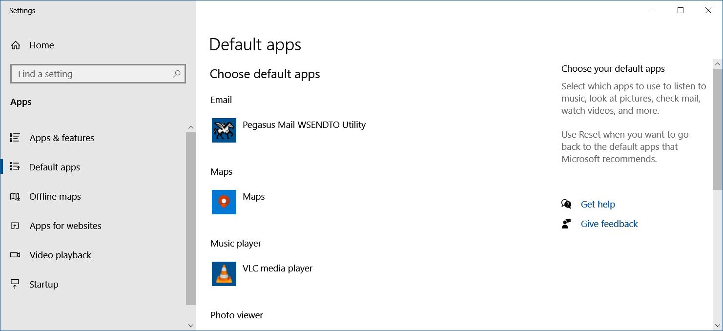

I am curious what caused it to stop working. Is there any correlation to a Win10 update? I have heard about Microsoft resetting defaults, especially if you have Outlook installed, but normally, re-establishing Pegasus Mail as the default email program fixes it.
I don't know of anything more to suggest. Is the Pegasus Mail SENDTO utility showing as the system default Email app?
65c78c005cc52
I am curious what caused it to stop working. Is there any correlation to a Win10 update? I have heard about Microsoft resetting defaults, especially if you have Outlook installed, but normally, re-establishing Pegasus Mail as the default email program fixes it. I don't know of anything more to suggest. Is the Pegasus Mail SENDTO utility showing as the system default Email app? ![65c78c005cc52](serve/attachment&path=65c78c005cc52)
Yes, the Pegasus Mail SENDTO utility is showing as the system default email and no, there seems to be no correlation to to a Windows update.

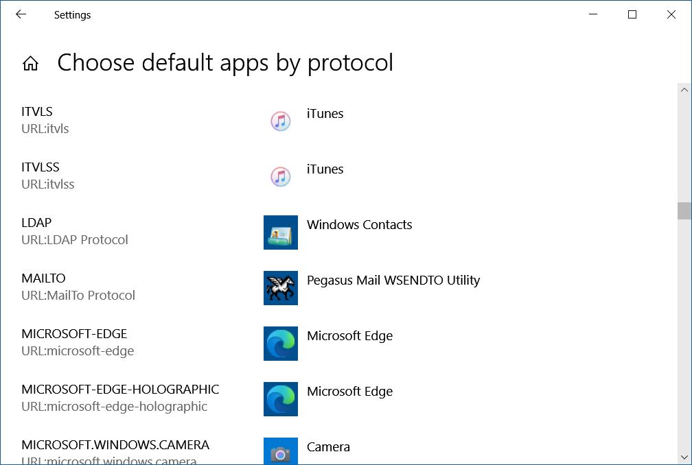

Check the default app for the mailto: protocol to confirm it is also set to the Pegasus Mail WSENDTO Utility. Beyond that, I'm clueless.
65ca1f9fb5ee4
Check the default app for the mailto: protocol to confirm it is also set to the Pegasus Mail WSENDTO Utility. Beyond that, I'm clueless. ![65ca1f9fb5ee4](serve/attachment&path=65ca1f9fb5ee4)
Well, apropos...when I uninistalled the little dingy email client I had installed, it somehow fixed it and now the SendTo works. All this just on my machine. Another one of those Windows "don't ask-don't tell" mysteries.
