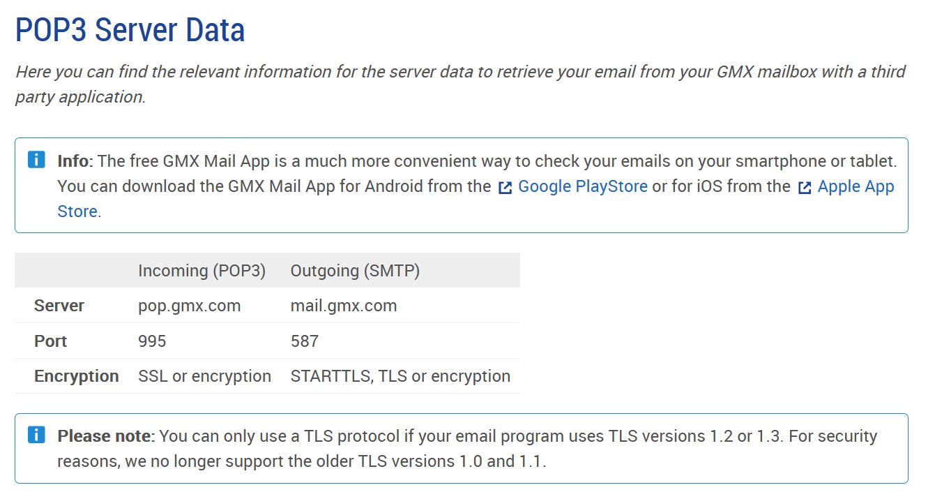

This are the requiered settings for pop3 and smtp data from gmx.com. Please try this settings and activate ssl:

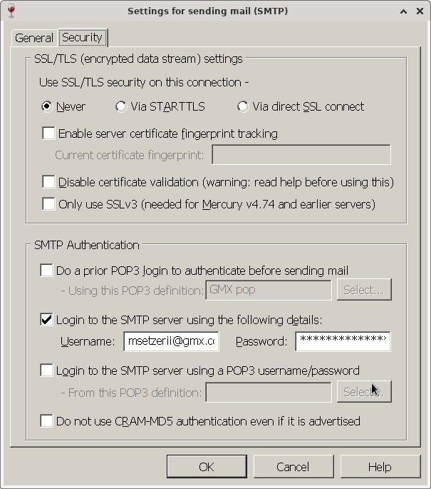

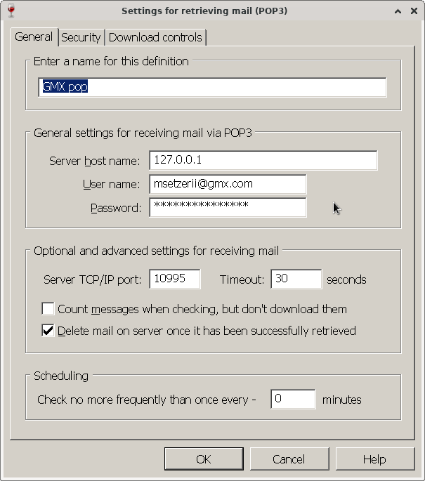

The Stunnel makes a local port connect to the remote port via an ssl connection, and uses the later 3.x version of openssl.
In linux the stunnel.conf file is located in /etc/stunnel/stunnel.conf.
With my setup, I use the linux stunnel to handle the connection versus using stunnel under wine.
Pegasus makes connection to local port that it does as local non-ssl connection, then stunnel takes the access from there to the ssl connection.
