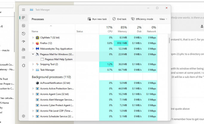

I have mentioned "Task Manager" a number of times but now suspect that you may not know what it is and how to access it. Without it I don't know how to identify whether Help is failing to start or is starting but running in the background. Would a step-by-step guide on how to access Task Manager and what to look for be helpful?
I'm not ready to give up if you aren't.
Tom, the content of the Info screen has clarified your installation. I have mentioned "Task Manager" a number of times but now suspect that you may not know what it is and how to access it. Without it I don't know how to identify whether Help is failing to start or is starting but running in the background. Would a step-by-step guide on how to access Task Manager and what to look for be helpful? I'm not ready to give up if you aren't.

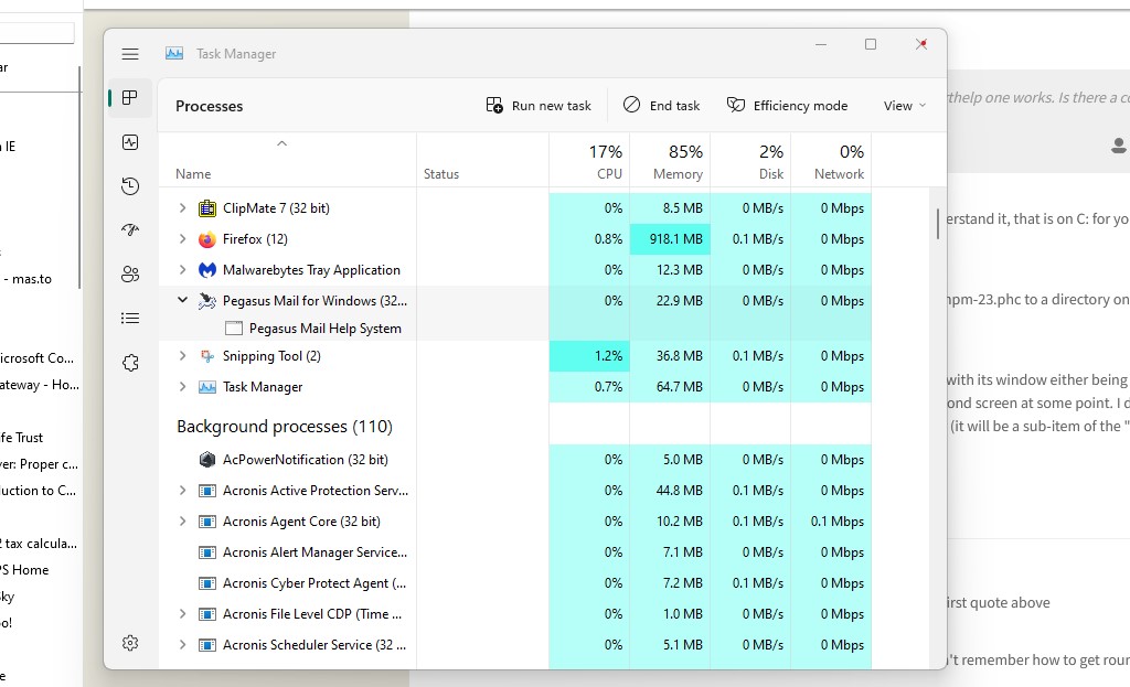

```` I have mentioned "Task Manager" a number of times but now suspect that you may not know what it is and how to access it. Without it I don't know how to identify whether Help is failing to start or is starting but running in the background. Would a step-by-step guide on how to access Task Manager and what to look for be helpful?>
See screenshot63dca8cfe9c52

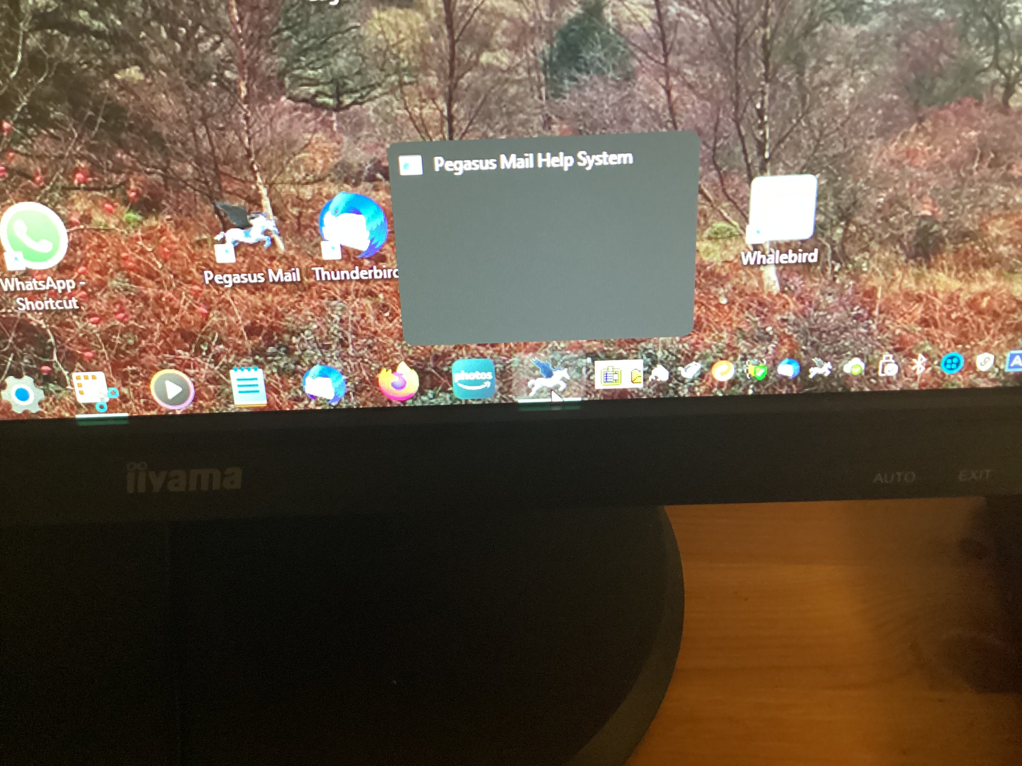

I’ve just discovered that, if I click on a Help option, then go down to the Pegasus icon on the Toolbar and put the cursor on it, a blank grey pop up for Pegasus Help system appears, but doesn’t seem to do anything - if I click on it, it disappears
63dcacca27720
I’ve just discovered that, if I click on a Help option, then go down to the Pegasus icon on the Toolbar and put the cursor on it, a blank grey pop up for Pegasus Help system appears, but doesn’t seem to do anything - if I click on it, it disappears ![63dcacca27720](serve/attachment&path=63dcacca27720)

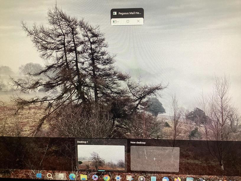

No idea what the Task View button is on the Toolbar, but it gives this
No idea what the Task View button is on the Toolbar, but it gives this [63dcba5ae22ff](serve/attachment&path=63dcba5ae22ff)
You have confirmed that the Help system is running. In your Task View, notice those buttons at the bottom of that small Pegasus Mail He... window.
The "X" will shut it down.
The box in the center will maximize it.
I don't know what the button on the left will do but I would try it first.
You have confirmed that the Help system is running. In your Task View, notice those buttons at the bottom of that small Pegasus Mail He... window. The "X" will shut it down. The box in the center will maximize it. I don't know what the button on the left will do but I would try it first.

Task Manager had already confirmed that it's running, but where is it?
I must come over as a right idiot if you think I would get that far and not try the buttons - they alll close it down. Occasionally the centre opens the normal Pegasus mail window Task Manager had already confirmed that it's running, but where is it?
Don't know. Pegasus Mail is doing its job invoking it.
It is a separate process so Windows has control of its window size and location. The only thing I can suggest is to right click on a blank area of the Windows taskbar and then select Cascade windows to see if it then appears on screen. Might want to close all other programs first. I am not certain that the Cascade windows option exists in Windows 11.
[quote="pid:55023, uid:7178"]Task Manager had already confirmed that it's running, but where is it?[/quote] Don't know. Pegasus Mail is doing its job invoking it. It is a separate process so Windows has control of its window size and location. The only thing I can suggest is to right click on a blank area of the Windows taskbar and then select Cascade windows to see if it then appears on screen. Might want to close all other programs first. I am not certain that the Cascade windows option exists in Windows 11.

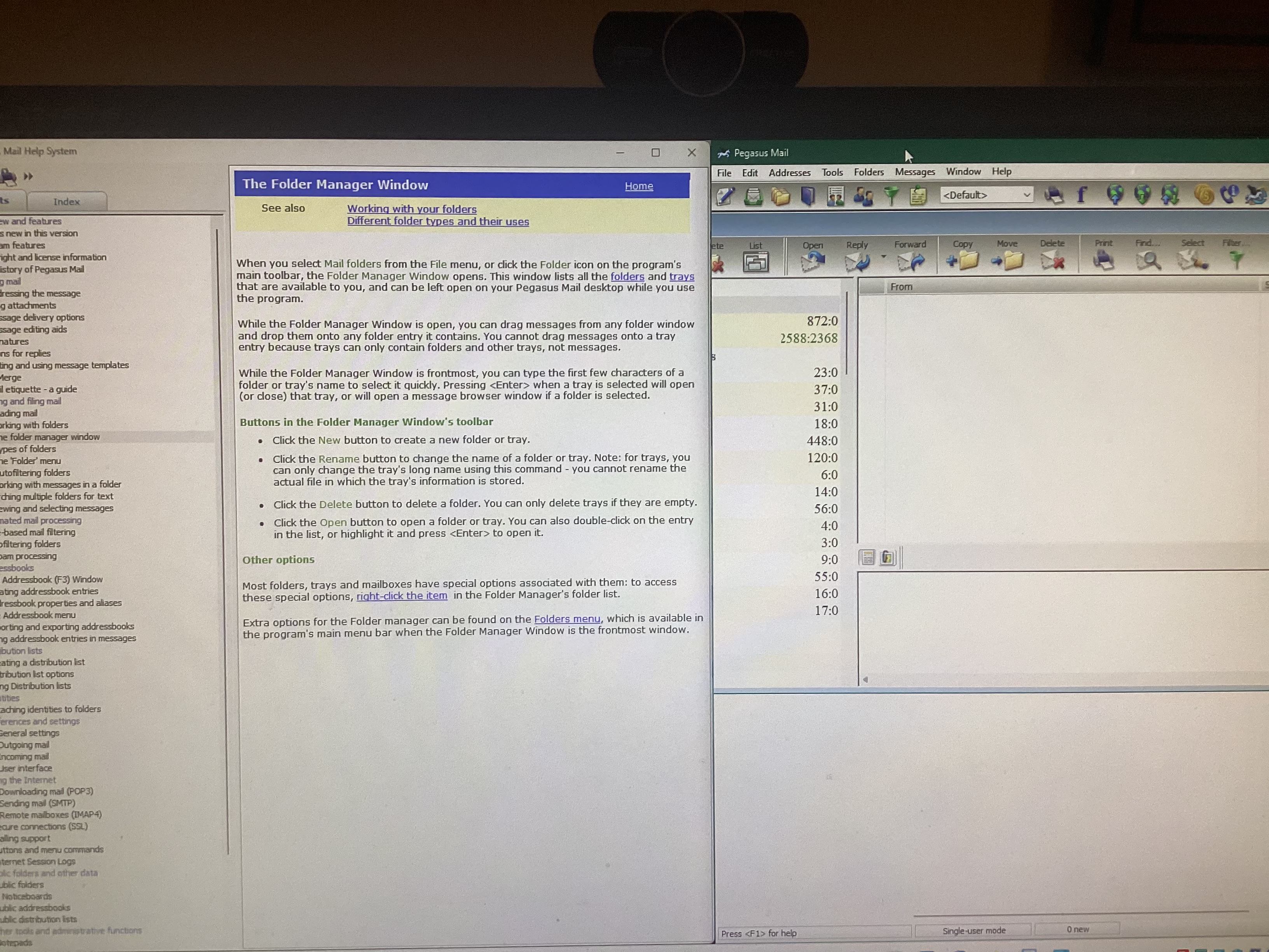

And now the Help file appears in PMail if I click Help! Bizarrer and bizarrer!
63e274e56ce4e
And now the Help file appears in PMail if I click Help! Bizarrer and bizarrer! ![63e274e56ce4e](serve/attachment&path=63e274e56ce4e)
