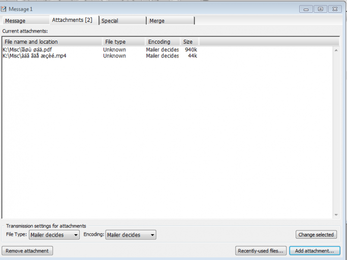

I'm talking about the filenames. Nothing else. All I see is some accented English vowels.
I did not have this problem with version 4.70 nor in 4.21c. See filename in the enclosed image.

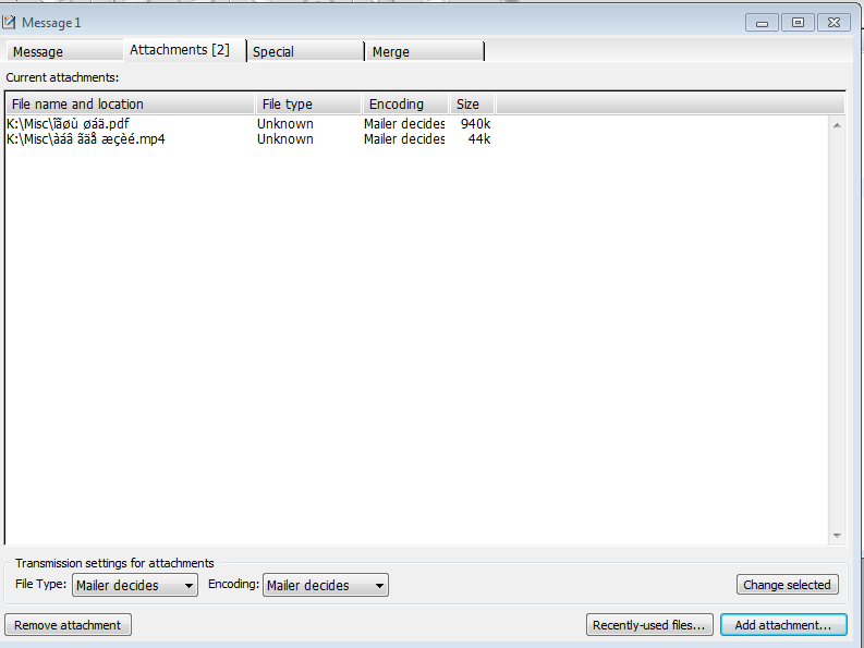

I'm talking about the filenames. Nothing else. All I see is some accented English vowels. I did not have this problem with version 4.70 nor in 4.21c. See filename in the enclosed image. ![62e6e6a9540cf](serve/attachment&path=62e6e6a9540cf)
Ok, now we're getting to the point: Lots of things have changed since the versions you mentioned were created including Windows (i.e. all versions) becoming fully Unicode based and Pegasus Mail supporting different sreen resolutions and character sets. Now it would be more interesting to know whether this changed when updating from 4.73 to 4.8 because that's when David Harris reworked the screen resolution support. Email message character sets shouldn't have a bearing on your issue but you're system's default font set for controls like Window captions, menus, buttons, lists (like in a file explorer window) etc. might have one. I guess I can get a more or less quick answer from David Harris about this, but: I assume you're using PM v4.8 now, is that correct? On which Windows version?

Yes, I'm using 4.8 which I updated from 4.7 on Windows 7. I very much appreciate your getting to the bottom of this issue.
I think Mr. Harris has added the UTF-8 support to the message body, but the Header lines don't fully support it, as probable filenames for attachments. So the multi-byte utf-8 codes get converted to various weird characters.
In other words, it cannot be changed until the next version?
Looks like that's true, David Harris has been notified and said he would look into it.
