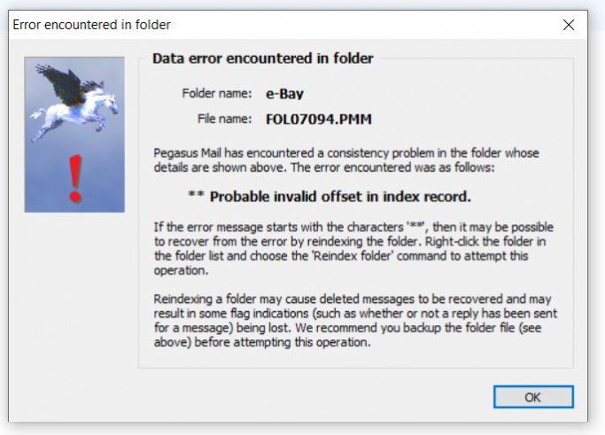

195
Got another email message from ebay that crashed Pegasus.
Has another of the super long lines.
Just opened the CNM file and removed the long line. Just cut it and pasted it to a badrover file. Then message opened fine in Pegasus.
The original encoded message. Is 4490 characters in size

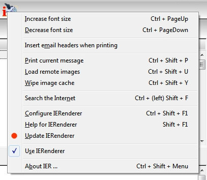

65
Be aware that I have experienced crashes of Pegasus Mail that appear to be the result of clicking the "Test" button associated with the Web search URL in IERenderer 2.6.6.0 configuration. This is reproducible on both of my Pegasus Mail instances but has yet to be confirmed by another individual. Please test this and report back if you care to.
The crash does not occur for me with IER 2.6.5.18.

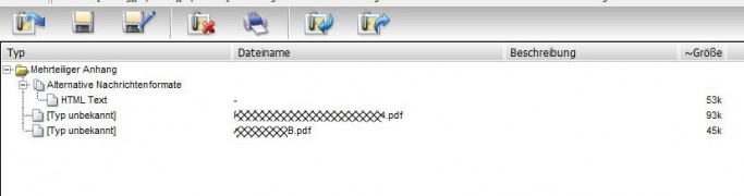

I received a link in an html formatted email as part of an email verification process for a site.
However, whenever I clicked on it, right mouse clicked to open the link in a browser or right mouse clicked and copied the link target to the clipboard, the link content changed and did not correspond to the plaint text underlying link in the email source.
This was reproducible in Pegasus V4.80 with IERenderer 2.6.5.18 with several emails from that site as well as with the sample code (link) below. I checked the same emails and link with Thunderbird and they worked ok.
During that process the following sample link changed from:
 https://example.com/#/verify-email?userId=3D54dd1&token=3DCfDJ
to
 https://example.com/?userId=3D54dd1&token=3DCfDJ#/verify-email
Could it be a bug in the IERenderer?
Many thanks
Thomas
