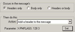

I have set mercury to save PDF-attachments from e-mails. Now Mercury should "Highlight" this e-mail in colour red. Unfortunately, the function is not executed.
If I use the Filter-action "Add a header to the message" (X-PMFLAGS: 128 1), the e-mail is displayed in red, but unfortunately the formatting does not fit for some emails.
Is there a way to insert X-PMFLAGS: without formatting the email?

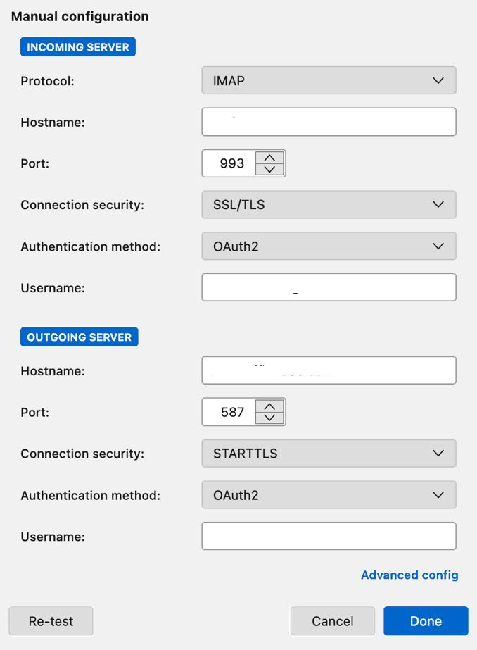

Our organisation has recently migrated to Microsoft 365. Since then I have been unable to access emails using Pegasus.
Instructions were sent that as yet do not include Pegasus, but do include Thunderbird.
Here are the settings for Thunderbird.
64594639beb62
I have noted that there is an option in Thunderbird to use Oauth2 as a method of authentication. This option is not available in Pegasus. I noted and found the option for gmail when setting up a new account but this does not work for my usual email address.
In addition I did find the settings provided by the Kansas State University to access emails using Microsoft 365, no mention was made of Oauth2 and these settings did not work.
I was successful in accessing my yahoo domain email address by following the instructions provided by Yahoo. It gives an option of using Pegasus as a third party app and provides a one time password.
Any solutions would be very much appreciated. I have been using Pegasus since the 1990’s, and continue to appreciate it.
Thank you.

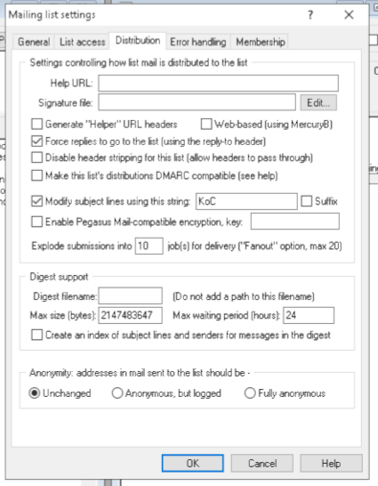

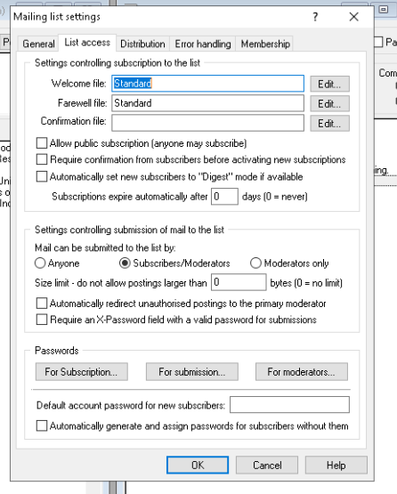

I have setup a moderated mailing list in Mercury 4.91 with 2 moderators. Listmembers are able to send to the list and should get their own replies. I just tested the list with my member address and Mercury started working the list. And than came the strange and buggy part: The sender was not my member address The From address was formed of the 2 moderators email address. It created a total mess.
MercuryE log:
T 20230424 212520 64473626 Begin processing job MO000016 from address1@sasktel.net address2@yorktondigital.ca
T 20230424 212523 64473626 Established ESMTP connection to 69.49.101.234
T 20230424 212523 64473626 MAIL FROM:<address1@sasktel.net address2@yorktondigital.ca> SIZE=1368
E 20230424 212523 64473626 553 5.1.3 <address1@sasktel.net address2@yorktondigital.ca>... Invalid route address
T 20230424 212523 64473626 Connection closed normally.
I can't see any wrong settings in my list configuration which could cause such behavior. I have 2 lists with 130/150 users.
Years ago with Mercury 4.01 I did not have such problem.
