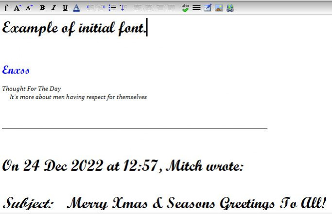

Hello The Forum,
Wondering if there is a way to Save my preferred font settings in the Pegasus Mail message composition box?
When I start a new message (or reply to a message) the font defaults to Courier New size 10. I know I can select other fonts and change the font-size, but I'd love to be able to set at the very least font-size 12 instead of 10...
All and any help most welcome.
Satch
